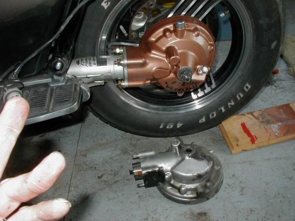

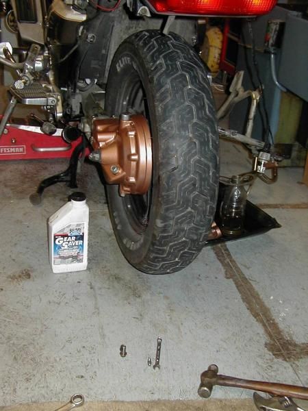

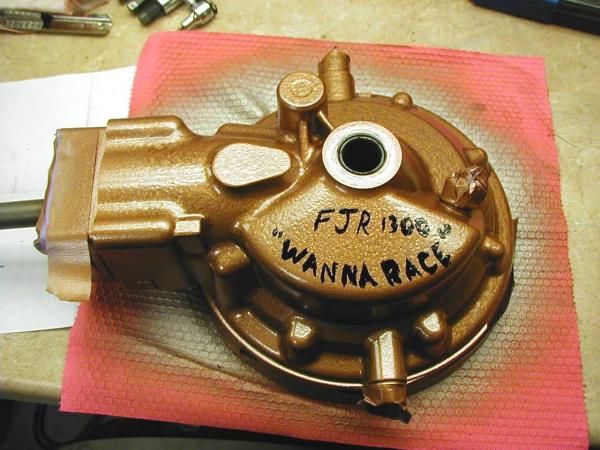

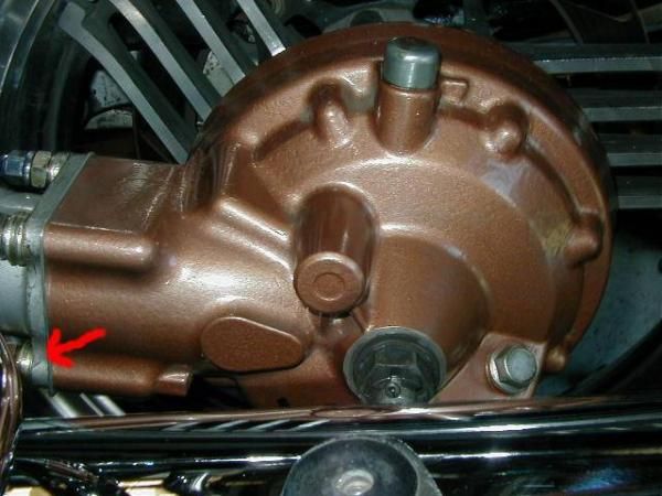

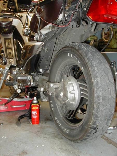

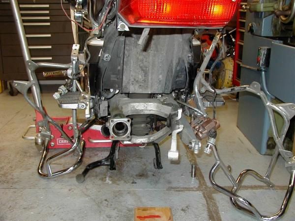

From the album: VR TO FJR1300 FINAL DRIVE SWAP!
THESE PICS SHOW HOW I MODIFIED AND INSTALLED A 2003 FJR1300 FINAL DRIVE ON TO MY 1987 VENTURE ROYALE. AFTER PUTTING ALMOST 10,000 MILES ON MY 87'VR I DESIDED THAT THIS BIKE HAD WAY TO MUCH "TOP END" I WANTED IT TO PULL BETTER THRU SPEEDS UP TO 80 MPH. WELL, LET ME TELL YOU AFTER THIS SWAP, SHE PULLS BETTER NOW! THE RED ARROW SHOWS WHERE I HAD TO ADD A .054" SHIM SO THE FJR1300 FINAL DRIVE WOULD BE PERPINDICULAR TO THE DRIVE SHAFT.
