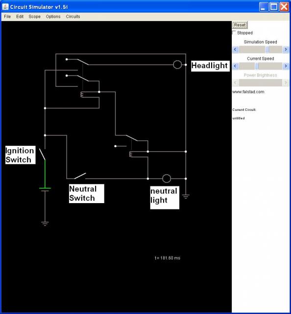

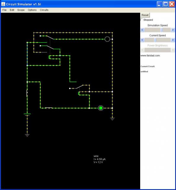

The best KISS would be to simply add an ON/OFF switch into the bikes existing headlight circuit. I like the idea of it being automatic where I do not have to remember to turn off the headlight switch before turning on the ignition. I did look at the time delay relay$$. That would be easy and would work but I don't want to spend that much if I don't have to. This relay circuit is not switching the power to the light, it is all control circuits. So I do not need high amp relays. I am sure that I have adequate relays, wire, and terminals in my parts box somewhere. That makes this a no cost option. The wiring should be pretty easy since the one relay is simply across the neutral light and the headlight wire is easily accessed via the unplugged and jumpered Reserve Lighting Unit. I'll try to take pics as I go.
Dang this headlight is bright! OK. I think I have the relay circuit figured out so that the head light will not come on till I shift out of neutral. For this to work the bike must be in neutral before I turn on the ignition. any time the power is on and the bike is out of neutral the headlight will turn on and stay on till the ignition is turned off. For those that want to play with the circuit simulator it is located HERE, and I have included the text file of this circuit to import. To import this file just click File>Import, and then copy-paste the contents of this text file into the window. Now you can play with the switches and watch the current flow animation. Now I just need to spec out and acquire the relays that I will use. More to come as I build this. Did I mention that this light is BRIGHT, I like it, and it is well worth any hassles along the way. 44804.txt
