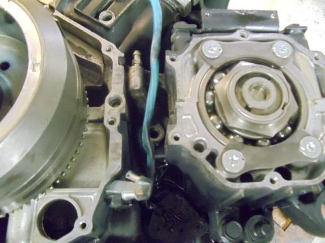

middle gear cover???
dingy replied to Saddle_Bag's topic in Venture and Venture Royale Tech Talk ('83 - '93)
Sorry Oz, I revised caption on first picture to indicate it was of the case, not cover as I originally said. -
Pictures of area in question below. Hole just below top center is bottom hole of where middle drive cover bolts to. http://i1007.photobucket.com/albums/af193/gdingy101/midcoversmall.jpg front view of middle drive cover http://i1007.photobucket.com/albums/af193/gdingy101/midcoveroutersmall.jpg Back view of middle drive cover http://i1007.photobucket.com/albums/af193/gdingy101/Middlecoverinside.jpg -
