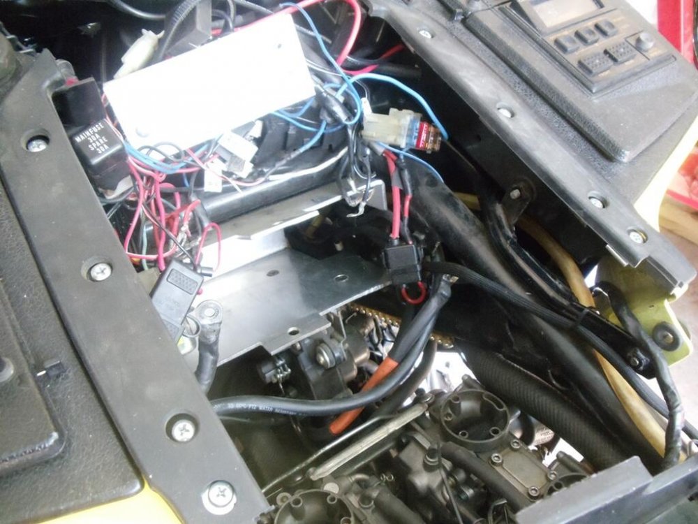

  1. What do you have as far as the air filter box and air filter? When I did VMax conversion on Tweety, I experimented with numerous modifications to air intake to reduce the power lag. Both the VMaxs and Ventures are sensitive to air flow changes, even running without tank cover on will affect it. I ended up relocating battery on its side where the coil pack was in order to get enough room to put a Vmax air filter housing on it. That was best thing I tried and worked fairly well. Coils were replaced with COPs VBoost servo motor is visible below new battery box on right side. Battery has been like this for 8 years now.
