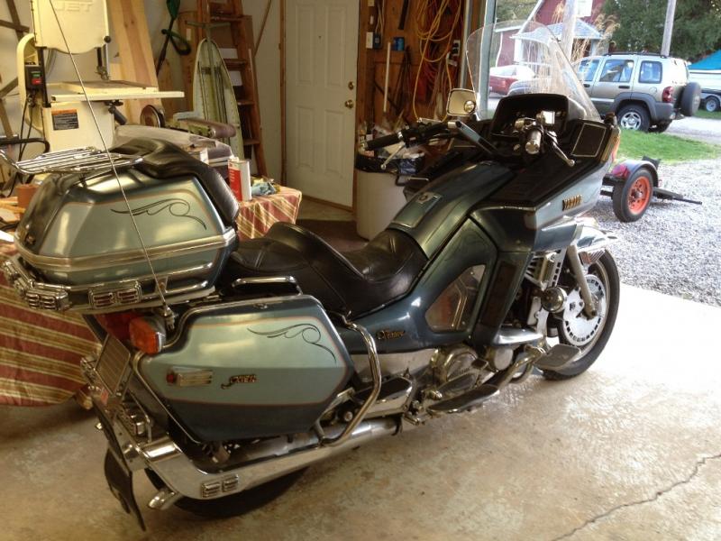

Picked up the 1988 Venture I bought last weekend this afternoon. Haven't dug into it at all, but after taking a closer look, it's not in bad shape overall. Needs a tab replaced on left side cover. Needs a new windshield & battery. CB & radio are working. Air compressor is not working 100%, No errors, but not engaging on rear end. Lights are working. Fuel tank looks good, no rust visible through filler. I am probably going to go over it well, replace some stuff like brake pads, fluids. Put in a set of progressive springs. Then try to resell it. Not a bad find by @cowpuc. Ended up getting it for $500. 83,500 miles on it. Stopped at a Yamaha dealer on way back, they had a new 2013 Goldwing with ABS for $23,100. It was real interesting. One thing I wasn't enthused about was the seat, felt very stiff. Also felt a little more cramped riding position than a Venture. Gary

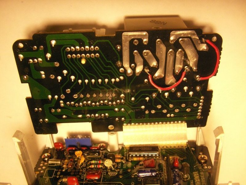

I have a good working stock TCI that I will loan you. The following will sound insensitive, deal with it. Since you are new here and no 'track record' I will want a $125 deposit and I will send it to you. You can try it in bike and if it works, you know what problem is. If it doesn't you saved throwing parts at it. If you want to, you can keep it, or return it to me. I will put it in my bike, if it works I will refund your deposit. I do have a fairly good 'track record' here and have not, to my knowledge, ever been unfair in any of my many dealings with people here or on ebay. Issue with borrowing one from somebody is the are a pain in the buttocks to remove from bike. They would have to be a dam good friend to do that. Gary -

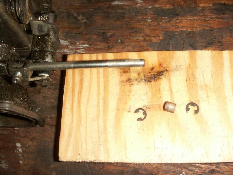

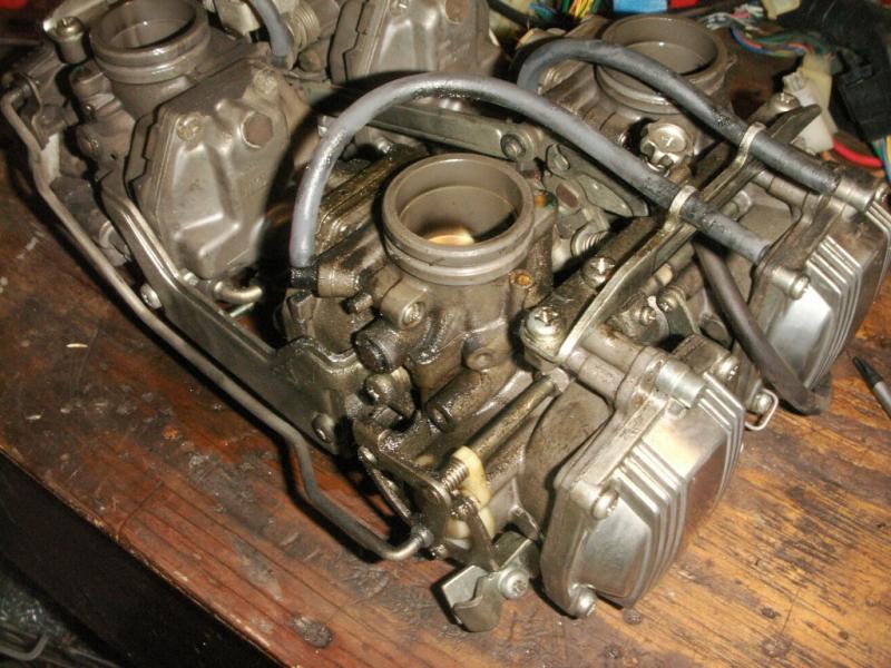

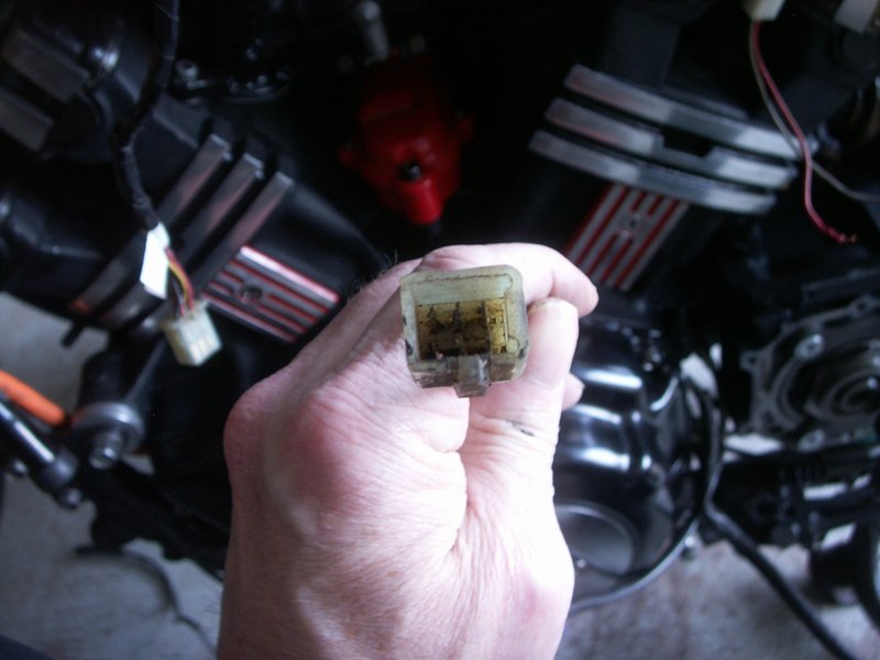

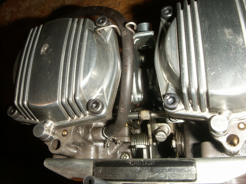

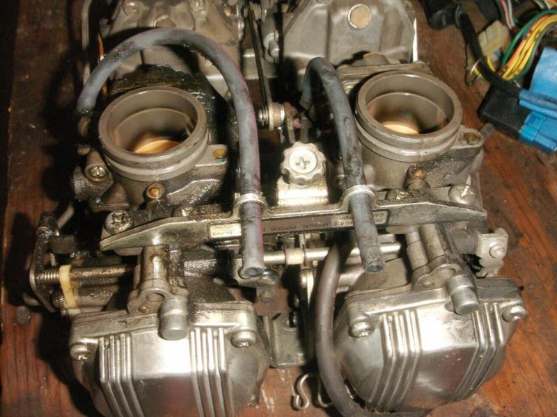

Need help with choke mechanism
dingy replied to Vonwolf's topic in Venture and Venture Royale Tech Talk ('83 - '93)

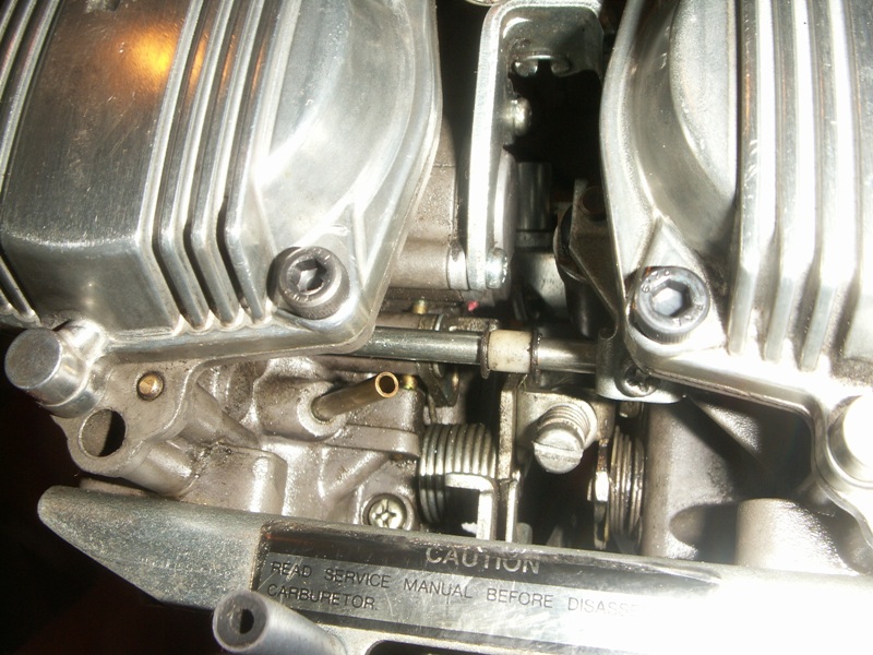

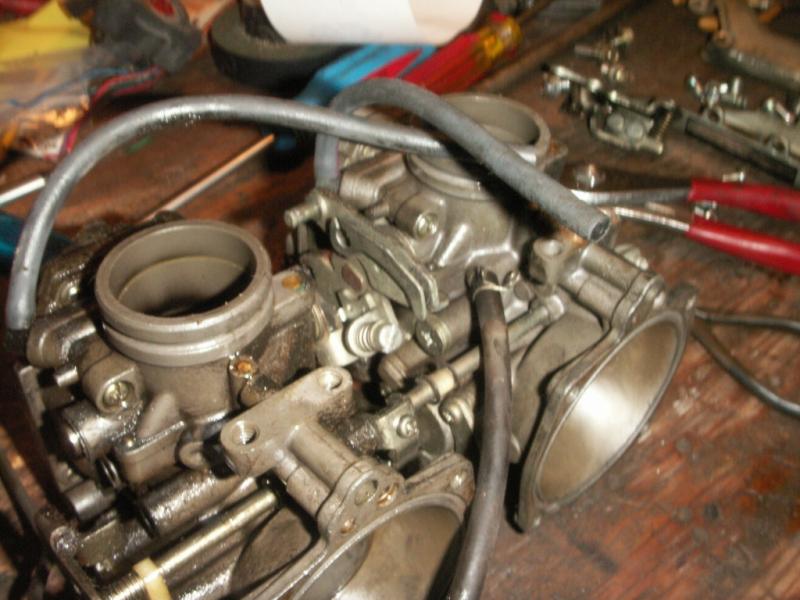

Post pictures of what you got left. Somebody will know where they go. Gary -

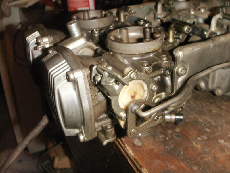

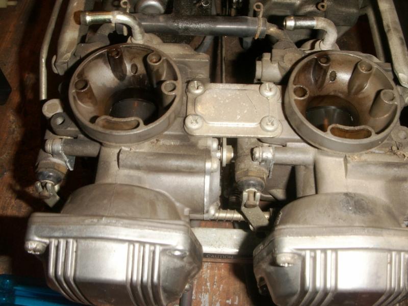

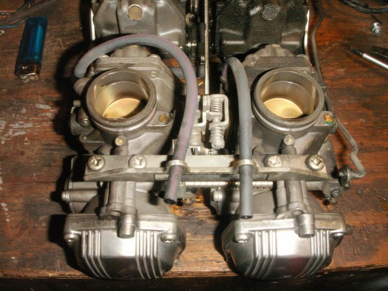

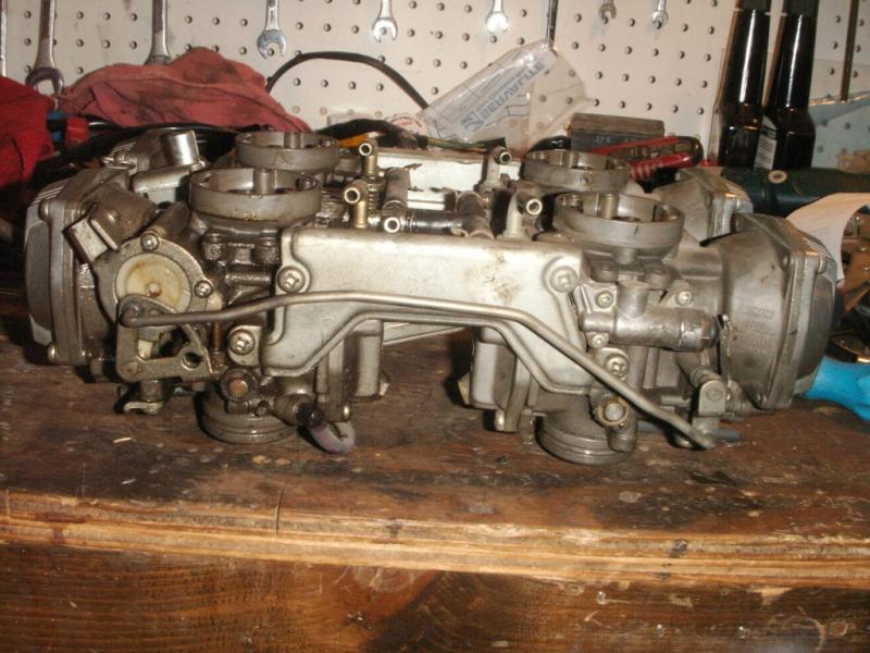

The parts fiche picture doesn't show many of the choke linkage parts. One thing not seen in pictures above is a nylon bushing that goes into each carb body on the choke linkage. I have a set of intact carbs if you need other pictures. Gary -
I'm going to go out on a limb and suggest a way of cleaning those that is 'out of the box'. Harbor Freight sells a hand media blaster for $18. Gravity Feed Blaster Gun It can be used as a small area soda blaster. Soda blasting uses common sodium bicarbonate (baking soda). See link below for use on copper. Seattle Soda Blasting Company Serving the Puget Sound | Call Today! The connector could be hand held with decent glove and cleaned. Residue clean-up possibly with water and allowed to air dry. I have no idea if this has been considered by anyone, a Google search on it came up with no pertinent matches. Don't try this at home, someone may come up with why this is a bad idea. Even after dis-assembleing pins from housing, cleaning the contacts manually and thoroughly would be very hard. Where the female pin wraps around would difficult to access. Gary

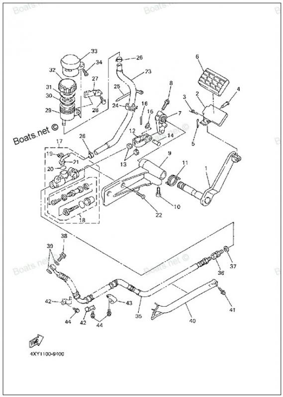

Just a thought on the heat convection to the brake line. The rear brake has a similar close encounter with right front exhaust, but Yamaha put a shield over it in that area. Maybe it was a cost decision not to do the front line on the RSV's. The front line is farther away, I believe, but still close. Item #40 in picture. Gary -
If you get to the point of believing it is TCI, I sell an aftermarket unit. http://www.venturerider.org/forum/photopost/showproduct.php?product=204&title=ingnitech-tci-2c-replacement-for-1st-genventures&cat=20 Gary
