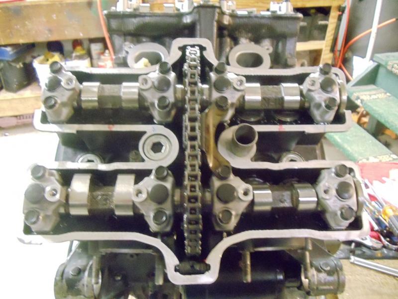

I attached a picture of the front & rear heads with cams in for a reference point. There is one way to time cams, you must use small holes for reference on rear head & large hole for the front cams. Only way the shim bucket could touch cam is if a shim is not installed. Gary 1986-1993-Yamaha Venture Cam install.pdf -

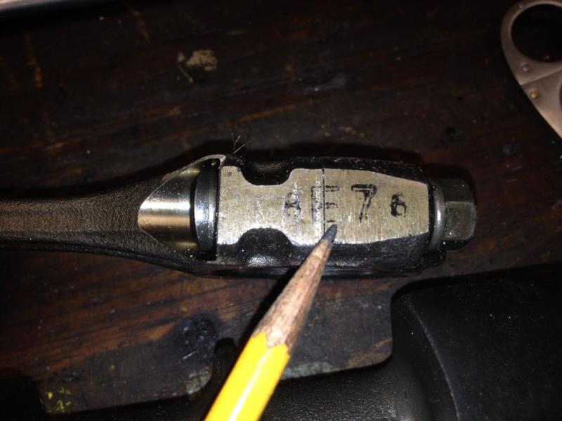

What are the parts shown in attached picture. A friend that is modifying a Venture has them left over. From an 87 MKII. Gary

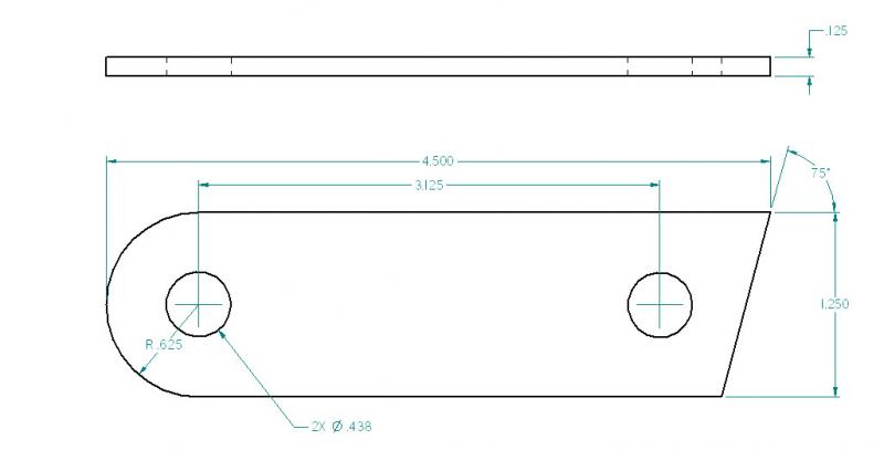

Here you are Larry. Bongo told me how to do it. Drawing of bracket needed. Picture of it on bike. Gary -

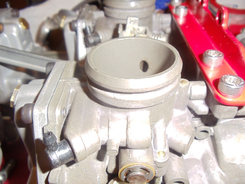

Easiest way I know of to tell difference if carbs are off motor is that the 86-93 carbs have a large chamfer on the lower portion that fits into intake manifold. The 83-85 have a very small chamfer. Pictures of each attached. The 86-93 set have the red crossbar seen on right side of picture. Also you can measure the throat of the carb. 83-85's are 34mm (1.34"), 86-93 are 35mm (1.39") Service manual is wrong about 34mm carbs on the MKII's. I have had racks from each side by side and they have a different bore. Gary -

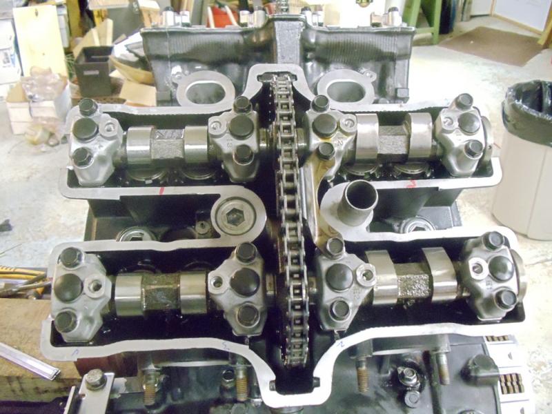

Attached is a picture of the balancer shaft & crankshaft laying in upper case half with marks aligned. If you look at the near side counter balance on the crank, it should give you a good reference for where the mark on yours should be. Gary -
