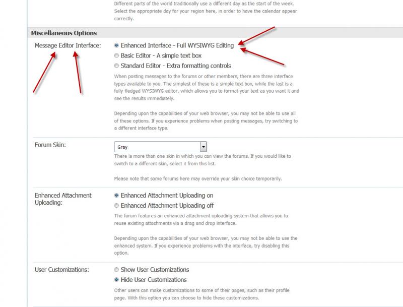

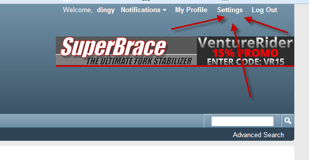

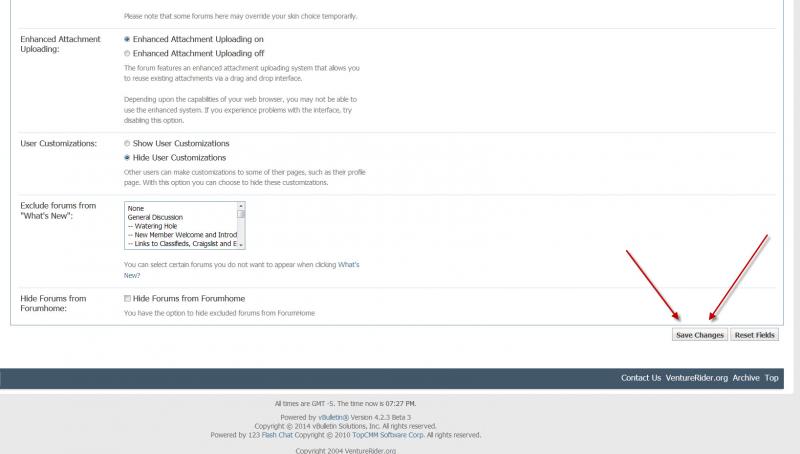

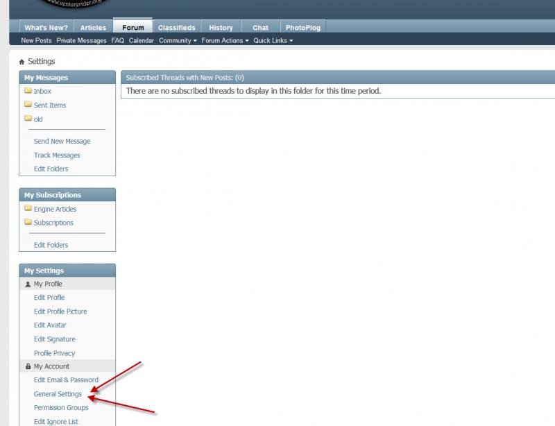

This is in reply to an issue in another thread, but I started a new thread as it may benefit others. Issue was difficulty setting fonts in message editor when replying to threads. Check setting shown in pictures below. Pictures may be expanded by clicking on them. Click on Settings in upper right corner of screen. Next window, click on General Settings, about half way down on left side. Next window, scroll down until Miscellaneous Options is on screen. Set the Message Editor Interface to Enhanced Interface - Full WYSIWYG Editing (What You See Is What You Get) Scroll down to bottom of screen and click Save Changes. Gary

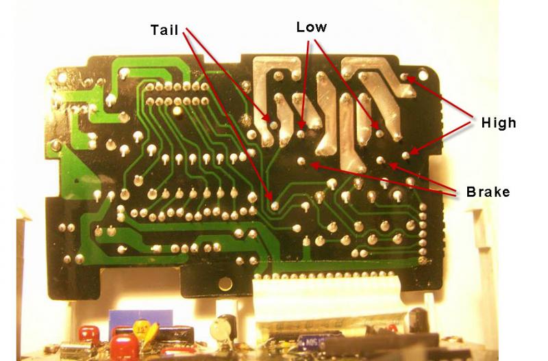

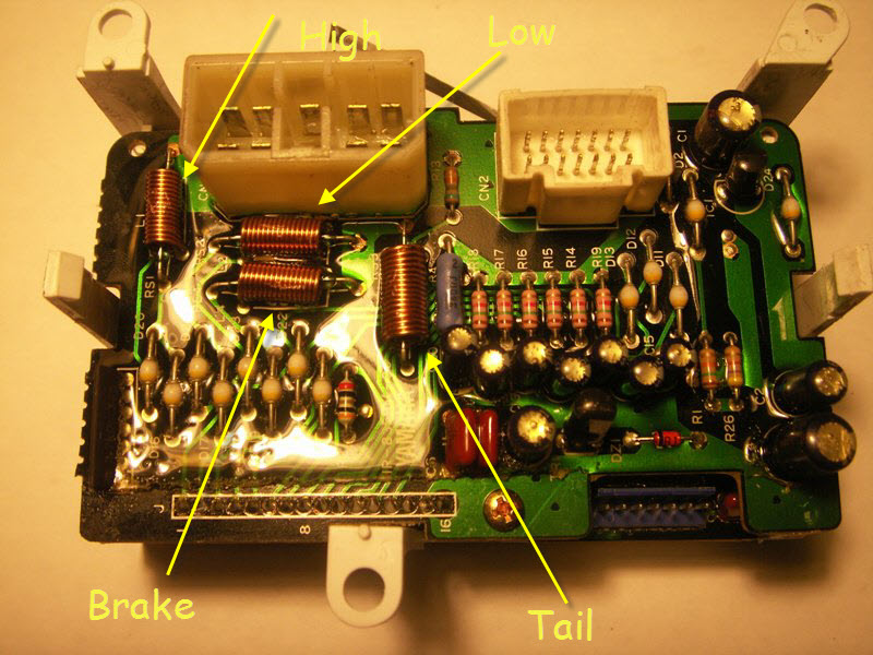

another brake light problem
dingy replied to diversity48's topic in Venture and Venture Royale Tech Talk ('83 - '93)
If you unplugged rear switch & brake stayed lit, the front switch contact in the brake circuit is most likely not opening when it should. See partial schematic picture attached. Link below shows how to disassemble brake switch & clean. http://www.venturerider.org/forum/showthread.php?t=42720 Gary -
