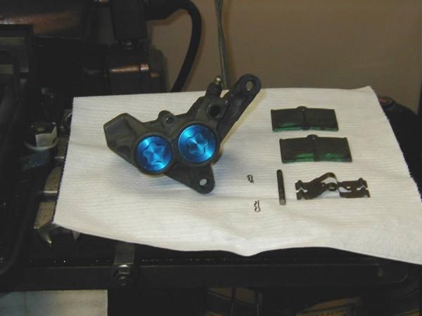

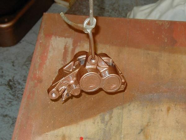

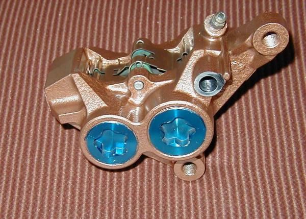

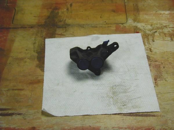

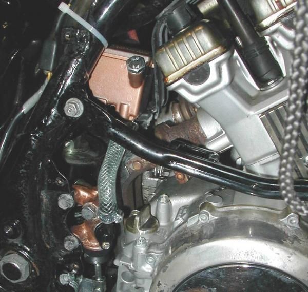

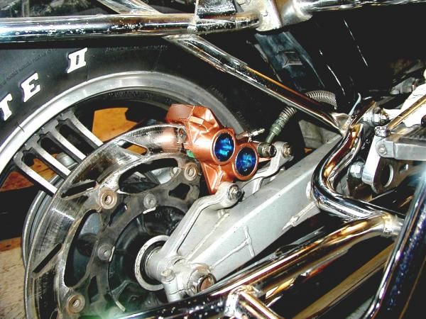

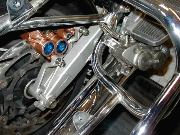

From the album: VR TO R1 BRAKE SWAP PART 2!
AFTER ADDING THE R1 BRAKE CALIPERS TO THE FRONT OF MY VR I SCORED A GREAT DEAL ON EBAY FOR A 2001 R6 RIGHT FRONT CALIPER AND A REAR BRAKE LINE FROM A 2003 YAMAHA V-MAX. I ADDED THEM BOTH TO THE REAR OF MY 87' VR. I FOUND THAT THE REAR MASTER CYLINDER WAS NOT ABLE TO HANDLE THE EXTRA BREAKING POWER OF THE NEW CALIPER SO I REBUILT IT. I ALSO ADDED A "SPEED BLEEDER" TO THE NEW CALIPER AND IN 3 MINUTES I HAD THAT REAR BREAKING SYSTEM BLED!
