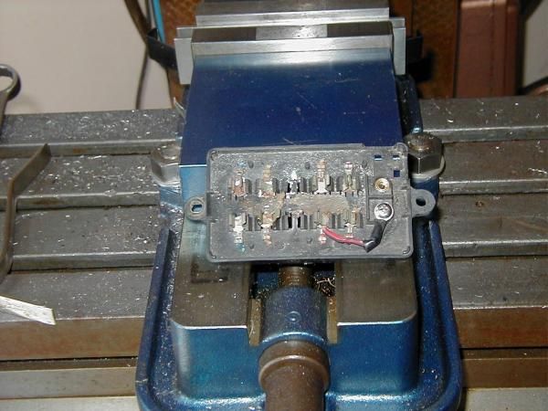

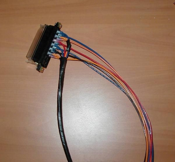

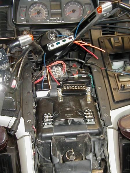

Hi To All, When I purchased my 87' VR at the beginning of this year I was not new to the First Gen. VR but now that this bike is 21 years old I have had to dig into her a lot deeper than I had on my other VR. While changing out the old battery the dreded "Battery Fluid Low" sensor fell apart in my hands. After crying the blues on this site, danob11 sent me his old one for free! Well now I had a part but being a Machinist by trade electrical issues are like Greek to me. A short time after that I received an invite from a small group of riders from this site that live in my area, so after traveling about 50 miles from my house my Fusebox fell apart at 55 mph. My brother came with the trailer and drug me home and I missed the ride. After some paperclips and crazyglue I again started out for West Virginia to make it to the WV Skid-In, this time with the bike fully loaded and with Jean on the back. We didn't even make it out of the state of Pa. and again the fusebox crapped out! I whinned on this site again:fiddle:, and Lonestarmedic sent me pics of his fusebox replacement, answered all of my questions and assured me that even though I am all thumbs with wire, I could do this! I bought a soldering gun, a new fusebox, a s***load of wire, and over the weekend of the 4th installed the battery sensor and the new fusebox. I only burned myself about 50 times, and I also found out that a soldering iron lights my cigars really well, but doesn't work for soldering after that without a good cleaning! So many problems went away after the new fusebox install, from poor charging to excessive amp draw when the brake lights were used to just flat not running! My most humble apologies to the riders I stiffed on my first outing and to Skid and his wife for not making it to the Skid-in. I also owe an apology to my wife Jean for dragging her to Bedford, Pa. and making her push me on the VR! Thank you once more for the help and friendship on this site, As I have gotten older I have found it harder to accept help from other people but the people on the VR.org site have softened my heart and I just wanted to say so. I posted a few pics of the new fuse box, If anyone has any questions about where I got the parts or is struggling like I was, or needs some brackets made, Please just ask! I feel I need to "Pay it Forward" for the kindness you all have shared with me. Ride Safe, Earl

Gee Guys, I apologize for not meeting up with you this morning, I left out early, (no GPS on this old girl!) and was about 50 miles out of Altoona when I hit a pothole in the road and the bike died. I pulled off the false tank cover because I have had trouble with the fuse block before and much to my suprize 4 of the 6 fuses dropped out on the ground! It seems the little fuse clips broke when the bike hit the pothole. A call to my brother and a trailer ride back to Duncansville later, I now have a bike that won't run. Again, I am very sorry I missed the great ride and hope to make it up to you Cecdoo and Roy. Cecdoo, did you mention a maint. day in the near future? Is it in Pa.? Please don't give up on me yet guys! Earl
