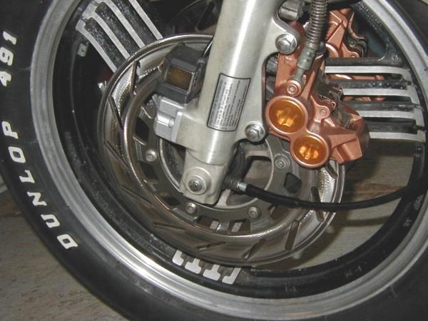

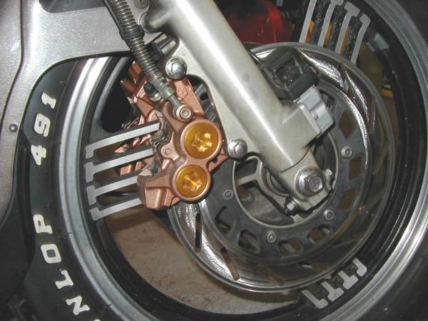

Hey Squeeze, In Case you missed the "Thank You" in my earlier post, THANK YOU VERY MUCH!!! For helping me with this brake mod. Even my 86' NEVER stopped as well as my 87' does now. My full time job has kept me very busy lately and I have been trying to "squeeze" (no pun intended!) the last of the riding season out of this area but in the very near future I will be adding a pair of modified R1 semi-floating rotors to the front of my 87', I will keep everyone posted as that project unfolds! In my 52 plus years on this planet I have prided myself on "thinking outside the box" and are accostomed to "nay sayers" but because of Squeeze's easy, matter of fact, communcation style, I never doubted the information he gave me, and when I paniced a few times, like when the master cyls. needed to be rebuilt, he calmed me down, walked me thru it step by step, and all came out as I (he) knew it would! This young man is a walking encyclopedia of tech. facts about the First Gens. and VMAX's and my Hats off to him!! Ride Dafe, Earl

As I said at the beginning of this thread, I was trying to bring about a MAJOR change in the quality of my braking system on a BUDGET. The cost of the four stainless steel lines you would need for the first gen. VR cost 2 to 3 times more than I have in this entire upgrade. I was looking for the most BANG for the buck, so to speak. I'm not saying that SS lines won't end up on my VR in the future but at this present time, the $200.00 plus dollars for SS lines would not have addressed any of my problems with my siezed front or rear old two piece calipers, or the failure of my front and rear master cylinders. Not to mention I bled all three calipers in 8 minutes, from dead dry to full braking power! Try to do that on a first gen., empty both masters, crack all three bleeders, and try to remove all the air in 8 minutes or even 8 hours! For those of you who have kept your first gen. braking system in tip top shape over the years and have not had any braking issues, you have my upmost respect! I purchased a used VR with major braking problems, and after much thought over the cost and what I would end up with after spending a BUNCH of money to refresh a 21 year old brake system back to 21 years NEW!?!? I chose to go the upgrade route. Perhaps this upgrade is not for everyone, but I have NEVER heard anyone say that their first gen. VR stopped TOO FAST! Just my thoughts on this subject, for what their worth. Ride safe, Stop Safe, Earl

It was a pleasure to see DavePa and his lovely wife Denise early this afternoon. I was sad to see them drive up in a cage, and not a new RSV! I understand that "all good things come to people that wait"! Dave and I ran to the shop, ohhh and ahhhed over the new brakes, and Denise was VERY patient with us, Jean and Denise chatted while Dave and I talked "Tech Talk". Their visit didn't last long enough, as I was getting ready for work. (2nd Shift) To Rick Butler I wanted to to say that high praise from someone like you with your vast knowledge of these wonderful motorcycles are kind words indeed! If I do run into problems with rear brake lock-up The "Butler Mod" will be the next item I add. Thanks for the suggestion about the stainless steel brake lines but I was trying to do this swap on a "Budget" and in the future, as funds permit, the SS lines will be at the top of my "wish list". Thank you all for your support and comments, I listen to them all, and as time and money permit I continue to evolve my VR into the "Superbike" I know these bikes can be! Ride Safe, Earl and Jean

Hi Dave, Thanks for the kind words! The calipers are a direct bolt-on item and the years are 1999 to 2003 R1's. Plus the 1997 to 2001 R6's are the same and they have a "really cool" blue dot on them! The reason for the VMAX brake line set is a lot of VMAX owners go to the braided SS brake lines and sell the stock line set dirt cheep. Also, you get everything you need including the front line splitter valve and the double banjo bolt you need for the front calipers. By the way you don't even have to remove the stock "hard line" that runs from the rear master to the front of the bike by the handle bars, I being on the "picky" side chose to get rid of all the extra stuff, and it made for a much cleaner look. If you need to know anything else, please feel free to PM me and I will be more than happy to fill in the blanks. Ride Safe, Earl

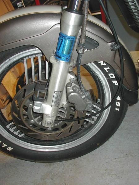

When I purchased my 1987 Venture Royale I noticed right off the bat that the left front rotor/caliper had major problems as did the rear caliper. The left front caliper was sticking so badly that it destroyed the LF rotor. After pricing rebuild kits for the three calipers, the rebuild kits for the front and rear master cyls. and the replacment of the bad front rotor my navigator/accountant said that perhaps I should just part the bike out! I sung the blues to SQUEEZE ( by the way thanks very much for giving me the courage to do this!)and he assured me that the solution was to replace the calipers with calipers from the Yamaha R1 and "de-link" the braking system. I really liked this idea because I also have a Honda V65 magna with the usual braking system. Both front discs operated by the hand lever and the foot pedal operating the rear brake. I purchased 2 front calipers from a 2002 R1 from Ebay for $40.00 with shipping. I also purchased a brake line set from a 2002 VMAX for $28.00 with shipping. Lastly, I purchased a set of stock, used rotors from Ebay for $55.00 with shipping. I picked up a front and rear master cyl. rebuild kit from Rick @ Buckeye Performance (by the way Rick, thanks a bunch!) and althou he was not too keen on me de-linking the brakes he was very friendly and provided excellent service, plus gave me a nice VR ORG. discount. Once the parts arrived, I removed ALL of the old brake lines, rebuilt the front and rear master cyls., installed the VMAX brake line set, moved the right front brake caliper to the rear (waiting on another good buy on a RF R1 caliper.) added a set of speed bleeders on all three calipers, and this was the beginning of the good part, I bled all three wheels out in 8 minutes!! Needless to say the braking is nothing short of UNBELIEVABLE! During one extremely hard brake test I came VERy close to lifting the rear wheel off the ground with NO front brake lock-up, and the decell was breath taking. The more brake lever you grab, the harder these new calipers work! I have included some pics, Part 2 will be the addition of an R1 rear caliper and part 3 will be the replacment of the stock front rotors with a set of modified R1 floating rotors. I will keep you posted as the rest of this story unfolds. Any questions, please feel free to ask me, SQUEEZE is the Master, I'm just the desiple. Ride Safe, Stop Safe, Earl.
THIS IS PART ONE OF A THREE PART SERIES ON MY PROGRESS TO IMPROVE THE BRAKING ON MY 1987 VENTURE ROYALE, ON A VERY LIMITED BUDGET!
1 STOCK VR CALIPER- THIS IS THE STOCK NON-FUNCTIONAL LEFT FRONT CALIPER.

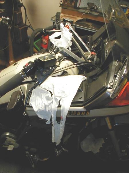

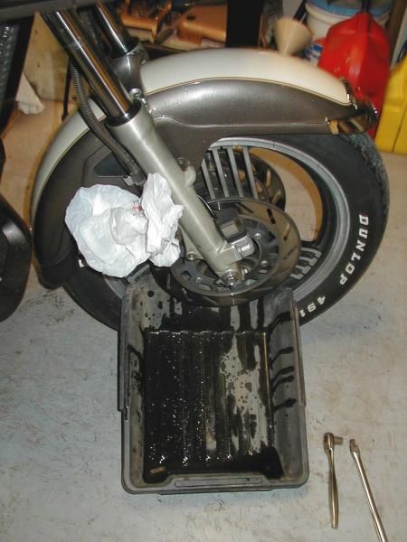

4 RF BRAKE REMOVAL- I USED WAL-MART SHOPPING BAGS TO MINIMIZE BRAKE FLUID SPILLAGE.
