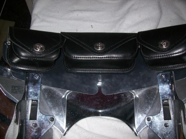

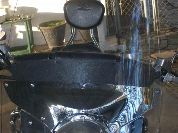

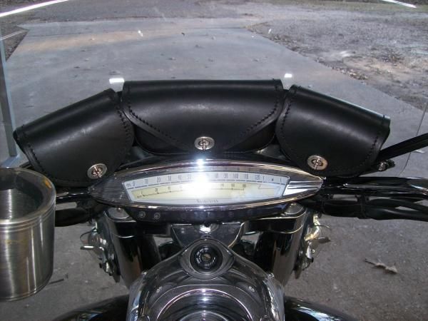

Since I bought my 2007 RSTD Midnight last year I have wanted to install a Tri-pouch Windshield Bag. I searched the forums here and elsewhere trying to locate one that would work, never finding what I wanted. Recently I took a chance and purchased a Carolina Leather Windshield Bag Number 721 http://www.carolinaleatherworks.com/winbag721.html This weekend I finally got a chance to install it and I am very happy with the results. I simply took off the windshield, Removed the three center bolts, inserted the bag, aligned it, marked the location of the holes, and drilled the plastic backer attached to the bag. I then installed the backer between the shield and the metal bar on the rear of the shield and reinserted and tightened the bolts. The only problem I had was getting the bolts reattached with the extra thickness of the plastic in there. After numerous tries I was able to get all the bolts reattached and everything reinstalled. I did loose the right side cables from their guide on the frontend of the bike to enable the bags to slide on and had to slightly adjust the cables to get the shield back on. So if you’re like me and searching for a windshield bag for a RSTD this might be the answer for you. Scott
From the album: Tri-Pouch Windshield Bag
