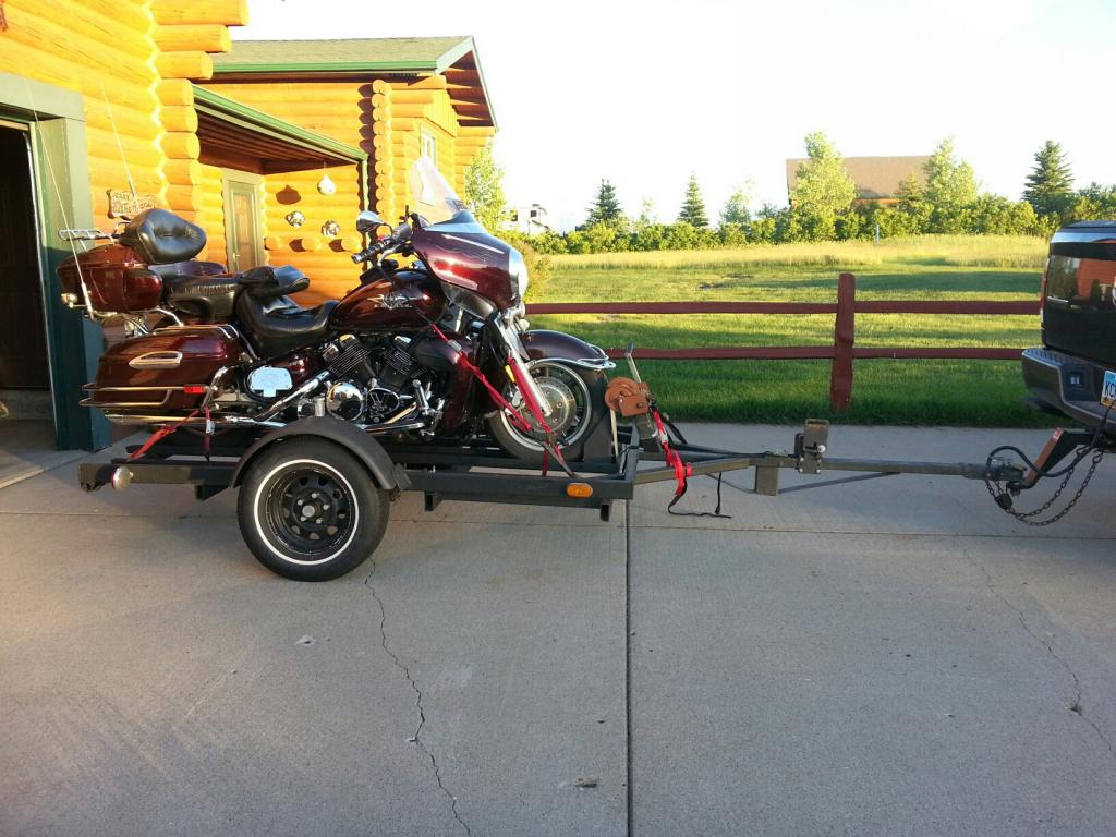

I'm thinking of modifying the trailer so bike moves forward 1 foot in relation to the axle. Not sure if I can have axle moved back, or cut front of trailer & add a foot on there. So at 10%, I should probably see a tongue weight of 100# or so...which is 75#+ away from what I have now.
Looks like the Avon Cobra tires have replaced the Venoms I've been running. In comparing the Cobra 150/90B15 to Michelin Commanders, I see a number of people here run both on their RSVs. Is there any concern that the Michelin only has a load rating of 74 (827#), while the Avon has a load rating of 80 (992#)?
I hauled my RSV 300 miles last week during a storm (then rode it 2000 miles). It's the 1st time I've trailered the 2006 RSV on this trailer, but I previously trailered my 1989 VR many times with no problems. Apparently the RSV center of gravity is different than the VR. The RSV center of gravity is located exactly over the axle (at least the center stand holes are)...giving a tongue weight of only about 25# according to my scale. The trailer probably weights 400#, the bike is probably 850#...so 25# tongue weight seems way too low...which would explain why the trailer was weaving back & forth while driving unless I was either on the gas or on the brake. So my question is...does anyone know where the RSV center of gravity should reside in relation to the trailer axle? or what the tongue weight when loaded should be? I'm thinking of modifying trailer so the bike moves forward about a foot...but who knows if that's enough or too much? Any "good" advice? Attached is photo of the loaded bike/trailer...
