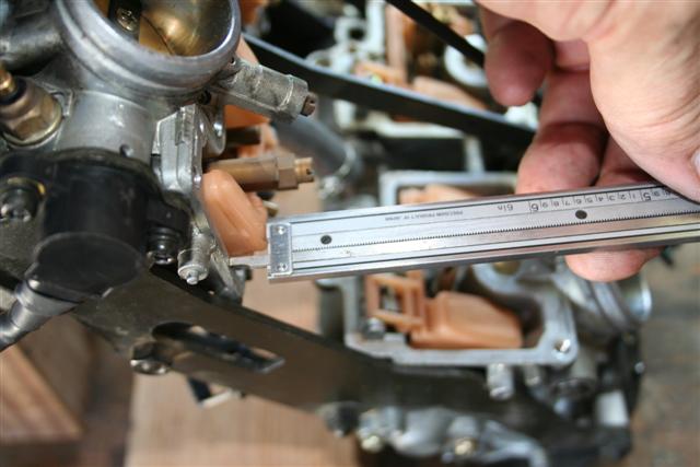

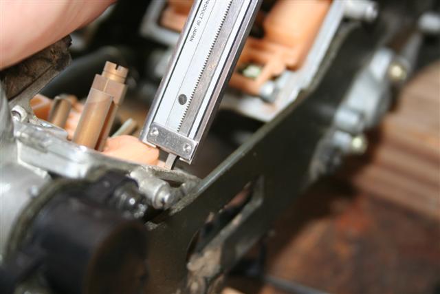

I don't make it to the rally in Harrison, AR. I've read and read the articles about adjusting the float levels in several posts so I finally convinced myself I should at the very least check them. So I now have RSV parts strung all over two garages. I hope I remember where all them little parts go. I'm mostly just kidding but I did take them apart and adjust the level and pretty much followed Goose's write up about it. I do wish he would correct the picture so that it shows the proper way of checking the floats. Anyway mine were not to bad I guess,two of the floats were .22 and the other two were .28. I now have them adjusted to what I think is .34 if I am measuring them right. I do not have the bike back together but I have a lot of confidence it will be fine. The thing I'm really looking forward to is the 10 percent increase in gas mileage that Goose promised. BOO

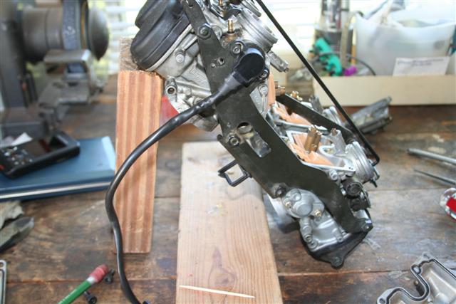

This post describes the proper way to set the carb floats on a 2nd Gen, as well as pointing out the errors in the factory shop manual. If you follow the manual as written, you CANNOT properly set the floats. ============================================================================================================ Today I decided to pull the carbs on my 05 RSV and check the float levels. My plugs looked perfect before I touched anything, so that doesn't sound like it was running rich. However, I ran down to Galveston and back yesterday (650 miles) and the chrome tips of my pipes collected a lot more black soot than I like. Even though my gas mileage is still running right where it always has (averaging 36 - 38), I decided to check out the float levels before my next big trip. I first tried the tube method to check the level while they are on the bike, but it just didn't seem to be working right or even close to an accurate way to measure them. So I bit the bullet and tore into it - Seems like a BIG job to pull that danged carb assembly out! The good news is, it really isn't that hard, just seems like it. Se the next post for tips on getting the carbs in and out. I was quite surprised to find that although all four carbs had the floats set very close to each other, they were WAY off the spec. Where the manual calls for .32 - .36", mine were all at either .133 or .285 (depending on how they were measured). That means the float level was set VERY high. And now to discuss the right way to measure the float height. The drawing in the shop manual clearly shows a carb being held upside down with the float bowl gasket surface level and the float height being measured with a caliper held vertical. Seems straight forward, no? But it is very wrong! Done that way, mine measured .133" instead of .34". The instructions even clearly state to "hold the carburetor upside down." But then the next thing is this NOTE: "The float arm should rest on the needle valve without depressing it." And that comment is the only thing correct about this procedure in the shop manual! Now having the float arm not depress the needle valve is a difficult thing to do with the carburetor upside down - in fact, it is virtually impossible; the weight of the float fully compresses the spring loaded plunger in the needle valve. When you lay the whole carb assembly flat on the bench, the carbs are already inclined quite a bit, but even then the weight of the float is still too much for the needle valve spring: Sooooo, I propped one end of the carburetor assembly on a short 2x4 so that the face of the float bowl was almost vertical. When you slowly raise the end of the assembly high enough you can see the float suddenly pop up from the spring pressure of the needle valve. Here is a picture of the carb assembly propped up and one of measuring the float height in that position: CAUTION: The floats have different shaped sides, and they are different heights too! The wide side of the float measures .04" higher than the other side. This means that you need to be careful to measure the SAME side of the float on all four carbs, and the wide side is the best one to use (note that the picture above is wrong, in that it shows me measuring the thin side of the float!). The most difficult part of the measurement is making sure the tool you use is held truly straight and perpendicular to the carb base, since any leaning at all will significantly change the measurement. On two of the carbs, you will find the choke rod or one of the carb mounting brackets in the way, so turn the caliper sideways a bit to clear the obstruction while still being held straight out from the carb base. I used this position to set all four floats at the mid point of the spec - .34" Bike ran great when I got it all back together, and the sync on the carbs was not changed by the procedure. I only put about 30 miles on it tonight, so I may not be able to report on the effect to my MPG calculation until I get on the road to Ontario next week. But I'll let y'all know how it changes, if at all. Goose UPDATE: OK everyone, the results are in, and this relatively straight forward maintenance procedure produced AT LEAST a 10% improvement in my fuel mileage! My carbs were in perfect sync before I adjusted the floats, and I made NO other changes. Although I have not had the time to check my fuel mileage under all conditions yet, I HAVE done about 2,000 miles of high speed, fully loaded, two-up riding. Under conditions that that have always resulted in about 32 MPG (80+ MPH and loaded, all day long), I now get 35-36 MPG. When running at an indicated 84 MPH, I can now get a full 200 miles out of a tank - never could get that far at those speeds before. And inside the chrome tips on my pipes look better now too - more brown than black. I expect it to get even better after I set the mixture screws soon.

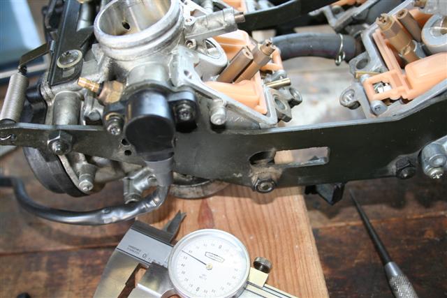

OK folks...I need some input here. I've seen several discussions on setting the float levels. I'm NOT much good when it comes to carbs. I can sync them and etc. but am always nervous about getting inside them. So yesterday, in my unending search to figure out my gas mileage problem, I decided to pull the carbs and check the float levels and etc. Several of you, including Cougar, Pegscraper and some others have done this and have reported that it's not a big job. WHATEVER...it took me about 10 hours to pull the carbs, set the floats and get it all back together. To make it worse, I'm now thinking that I may have done it wrong and need to pull them off again. The manual says that you set the floats at about .32 with the floats resting on but not compressing the needle valve. So, does that mean that with the carbs upside down that you lift the floats with your finger so that the tang is touching the needle and that is when you measure? Unfortunately, I set them with the carbs upside down and the floats at rest, not me lifting on them. I'm attaching a picture. You will see in the picture that the near side is laying way up in the housing. The far side I have adjusted and it is at about .32 with it just sitting there. I think I did it wrong but please tell me for sure. Here's the deal. Yesterday morning I check all four cylinders using my Colortune. At most all RPMS I had the nice Bunsen blue color as I should but had intermittent flashes of yellow. According to the color tune booklet, that is a sign of floats set too high. That is why I pulled them off. Finally got it all back together last night about 9:00 and fired it up. Now I have a definite backfire, pop, miss or something from the right side. Now I have not synced them yet and will do so but I really don't see where adjusting the floats would through the sync off. So.......HELP.
