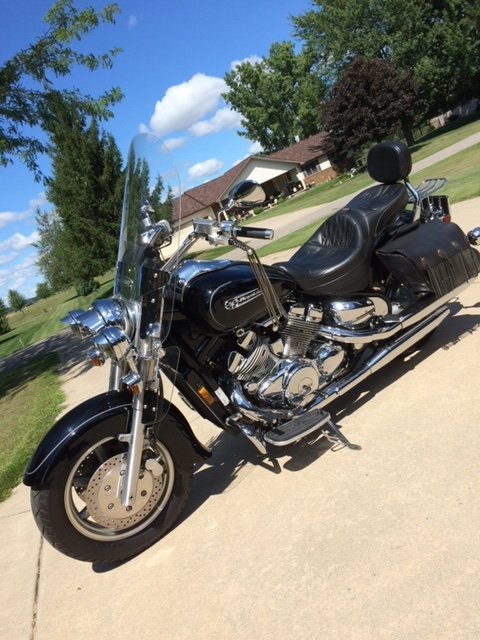

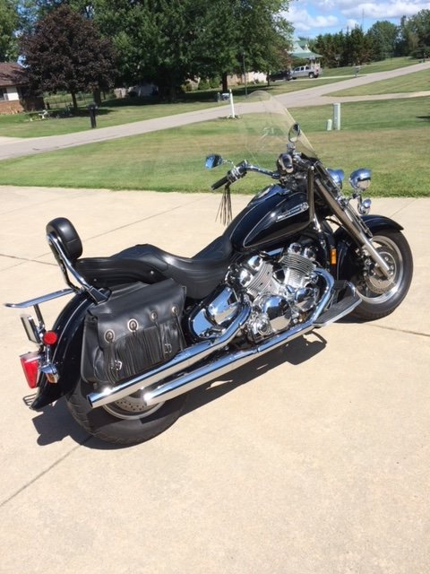

Yamaha Royal Star 1998, black and chrome. 11,665 original miles on 6-10-2023, original owner. ME 880 Marathon tires with ~1,000 miles. Use non-ethanol recreational gas whenever possible. Garage kept with Yamaha cover daily. Heated storage in winter. Extra windshield. Extra seat (custom Corbin). Extra exhaust pipes (Jardine slash cut). Yamaha shop/service manual. Stebel horn (and original horn). Yamaha rear back rest. Yamaha saddlebags. Yamaha handlebar pouch. Yamaha winter storage stand. Yamaha lower wind defectors. Various Yamaha chrome pieces. Yamaha chrome rear fender storage rack. SAC luggage case. SAC duffle bag. Two Shoei XSP helmets with cases and extra face shields. Two sets of rain gear (used once). Two black leather riding jackets. Two pairs of black leather riding chaps. Wife no longer interested in riding for ice cream. Collectively, $5,000 (wife not included).
