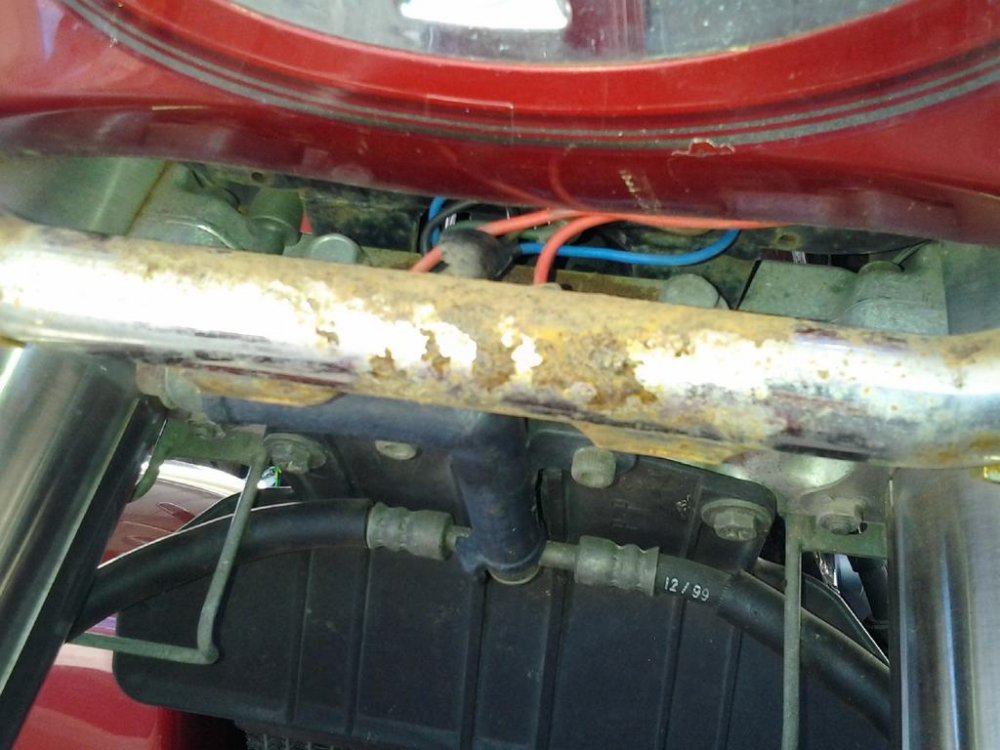

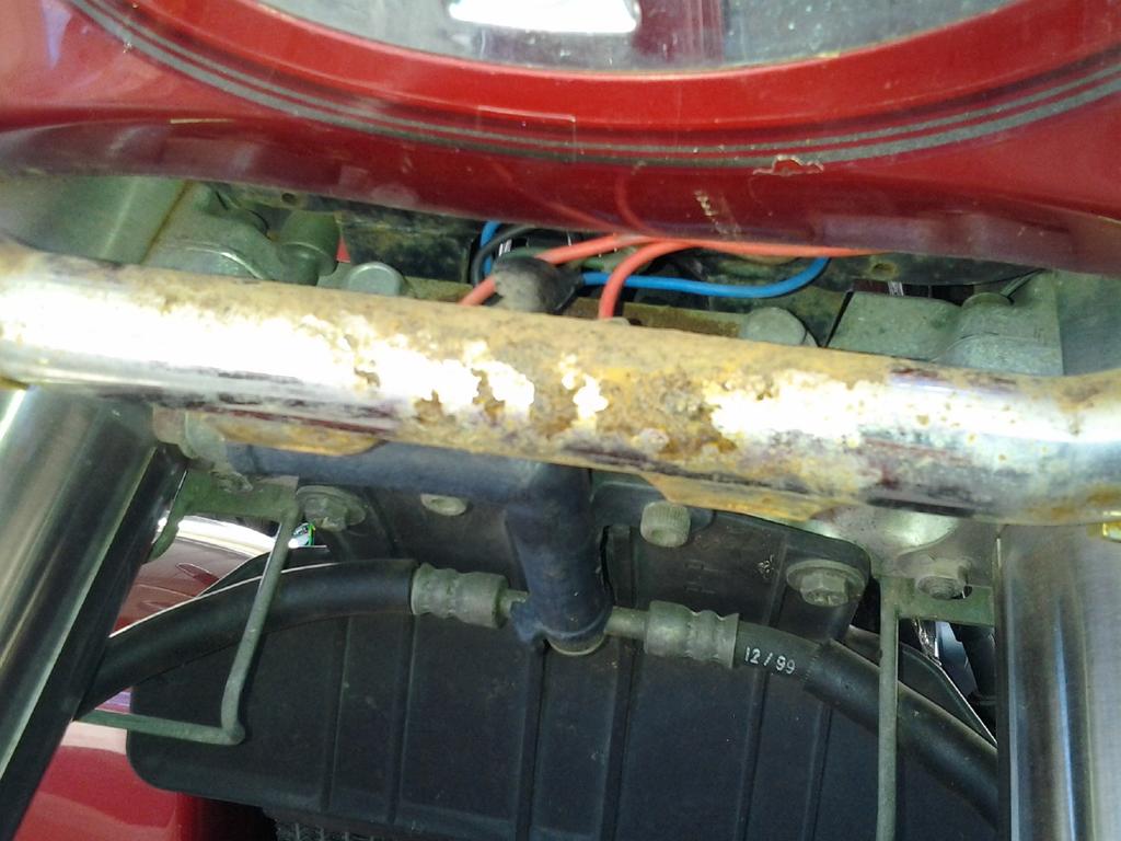

malenurse13 Posted January 31, 2018 Author Posted January 31, 2018 How would y'all handle all the rust? With my first motorcycle, years ago, I remember a lot of WD-40 and steel wool... What do y'all think??

slowrollwv Posted January 31, 2018 Posted January 31, 2018 The rust in the pic looks like the driving light bar. If it is too bad to clean up you can replace it. If you need a light bulb until you can replace those lights I have two you can have as I do not need them. I switched to all LED lights on mine a few years back. One other thing if you can find one, get a light bar extension bracket it will come in very handy when removing the fairing.
bongobobny Posted February 1, 2018 Posted February 1, 2018 Well, you can try some chrome cleaner or Brasso, but it looks like there is to much chrome missing. Here ya go... https://www.ebay.com/sch/Lighting-Indicators/180034/i.html?_from=R40&_vxp=mtr&selcontext=productType%3AMOTORCYCLE&selfil=1%2C2%2C3%2C6&selvel=2009~Yamaha~Royal%2520Star~XVZ1300TF%2520Venture&_nkw=2009+Yamaha+Royal+Star+XVZ1300TF+Venture And while you are at it, you want to figure out how to extend the bar further out so that when you split your front fairing you won't have to loosen and/or remove the passing light bar to get the fairing off! Some of us have made spacers, and some have designed extension plates.
