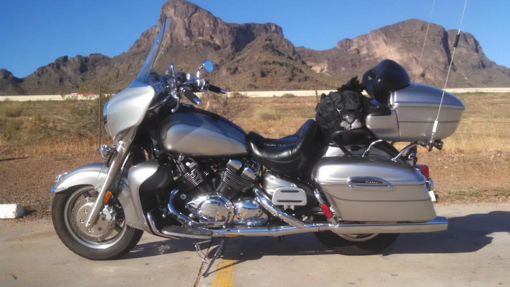

douglasp.burdick Posted August 17, 2015 Author Share #18 Posted August 17, 2015 Oh, it's just a stock,silver venture. Ill have some pics tomorrow and post them here. Thanks for all the help! it's reassuring to know the whine isn't detrimental, as my wife and I are taking it on a long ride in the ga mountains next month. it's a ride called the gauntlet. Link to comment Share on other sites More sharing options...
videoarizona Posted August 17, 2015 Share #19 Posted August 17, 2015 Silver...like mine! Link to comment Share on other sites More sharing options...
douglasp.burdick Posted August 17, 2015 Author Share #20 Posted August 17, 2015 Yeah. Silver. Here is a couple of pictures of it.and here is the bike it replaced. not real happy with my choice right now. Link to comment Share on other sites More sharing options...
