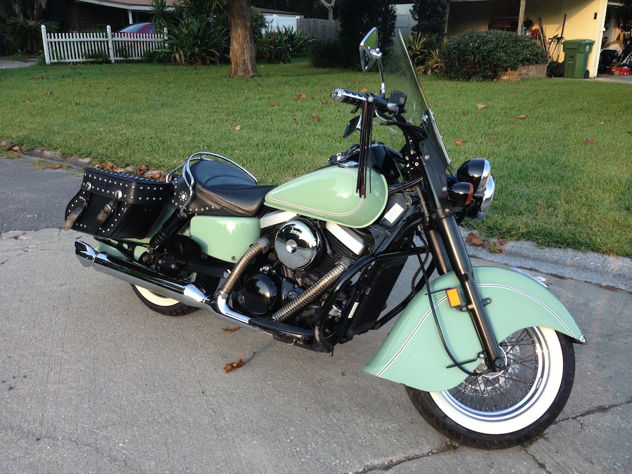

Beach Bum Posted August 19, 2015 Share #63 Posted August 19, 2015 I had a 99 Drifter. Nice bike but nothing compared to the RSV. Let me know if your dealer will comp a repair on yours and maybe I'll check mine to see if I can get some free parts. Link to comment Share on other sites More sharing options...

douglasp.burdick Posted August 19, 2015 Author Share #65 Posted August 19, 2015 (edited) I had a 99 Drifter. Nice bike but nothing compared to the RSV. Let me know if your dealer will comp a repair on yours and maybe I'll check mine to see if I can get some free parts. [ATTACH=CONFIG]101196[/ATTACH]Will do. I might hear something this afternoon and I'll let everyone know what he said. Edited August 19, 2015 by douglasp.burdick Link to comment Share on other sites More sharing options...
