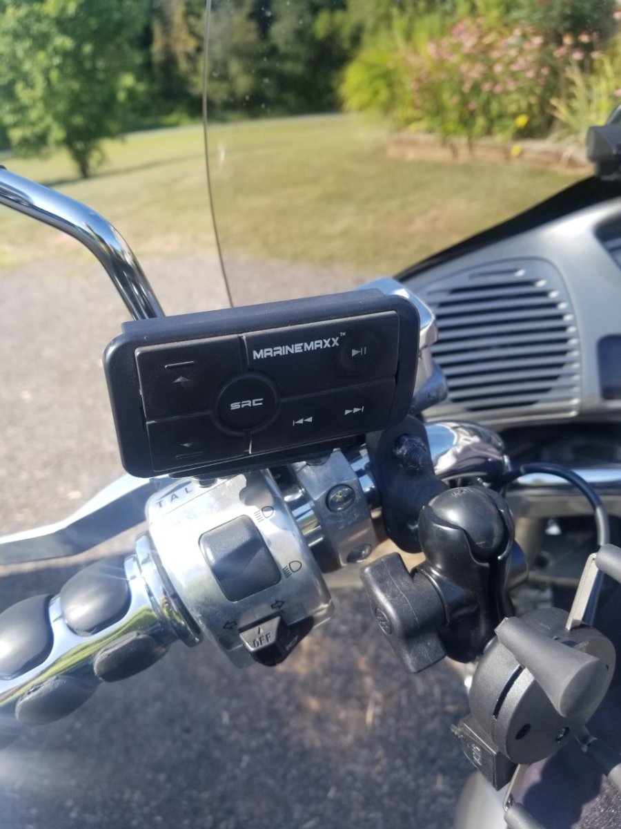

I used the existing wires. I removed the plug end from the original stereo and connected the amp wires to it so I could plug into the bikes wiring without having to cut the bikes wiring. Yes this is a amp that will blue-tooth music from your phone to the amp. I used the original bike speakers. I think they sound fine. I wasn't expecting a lot of bass just wanted clearer sound, I think that the extra watts put out by the amp makes the sound a lot clearer. Ron
It mounts in the same place as the original. I had to make a bracket to attach it, but it wasn't hard. Ron
I've had one of these installed since 2016 big improvement. https://www.amazon.com/Waterproof-Motorcycle-Bluetooth-Amplifier-Powersports/dp/B074X456TN/ref=sr_1_6?dchild=1&keywords=marine+grade+bluetooth+amp&qid=1609132766&sr=8-6 . The control is almost identical size to the original. Ron
