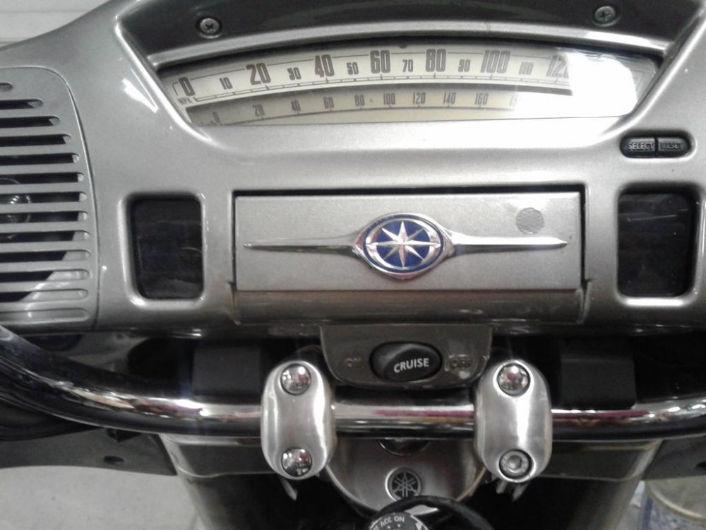

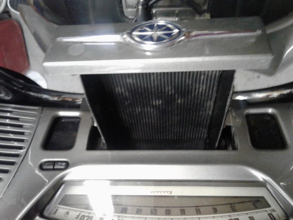

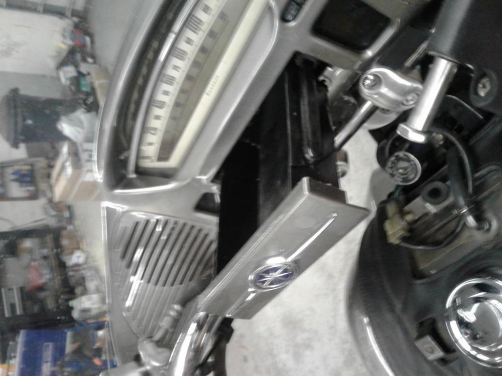

  12. I took the complete ashtray assembly out of a 1987 ford bronco I I. I mounted the upper assembly into the cassette player housing and then made a 4" x 5 3/4" tray out of 22 gauge steel. I then cut the sides off of the ashtray and welded them onto the tray I made. Then I cut the fold down door from the cassette player housing and cleaned the foam out of the inside of the door and filled it with jb weld. After that hardened I drilled and threaded 4 holes to secure it to the front of the tray. Ron
  13. Just finished removing my whole stereo system and CB. I installed a blue tooth marine stereo and custom made a storage tray to replace the cassette deck. Sorry the first picture is upside down I tried to flip it but couldn't, don't understand why it is upside down the original picture isn't. Ron
