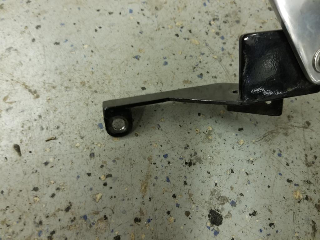

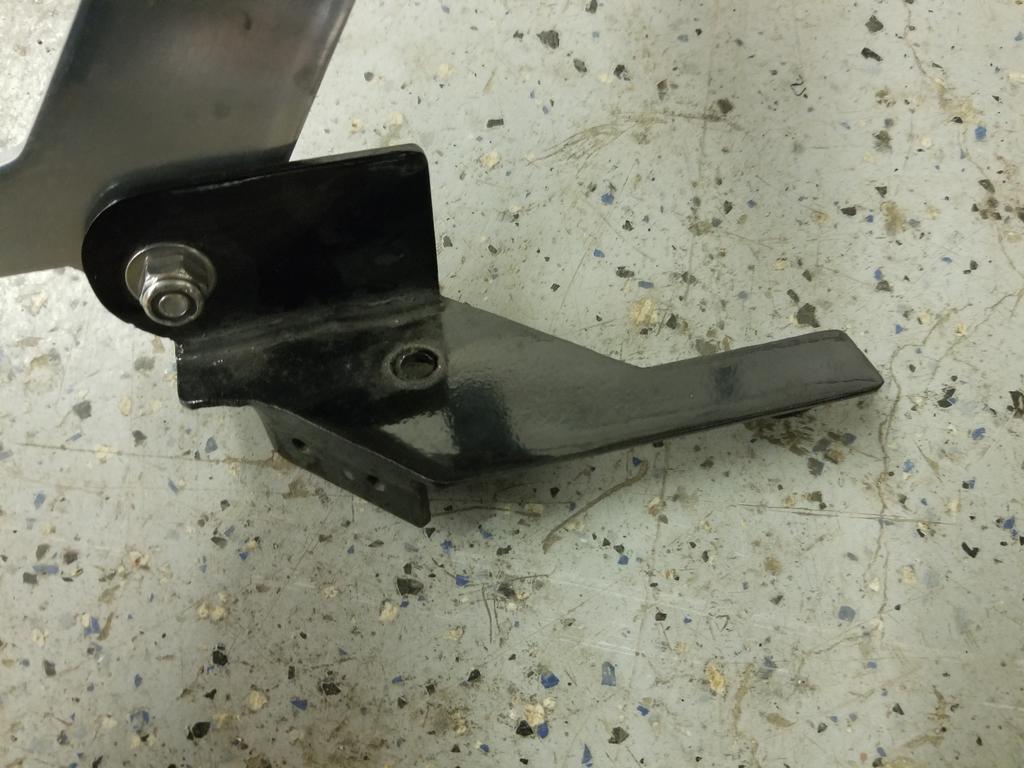

Here is a close up of the bracket. I didn't have a way to make the necessary bends so I made 3 tabs to weld on the top plate of the floorboard cover. One tab has a hole that aligns with the rear mounting bolt of the floorboard, the second one fits against the front of the floorboard and the third on bolts the arm to the assembly. I then aligned it with the floorboard and drilled down through the plate and floorboard and put a stainless steel bolt down through it to secure the front of the plate. Ron

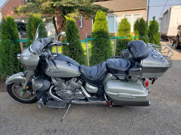

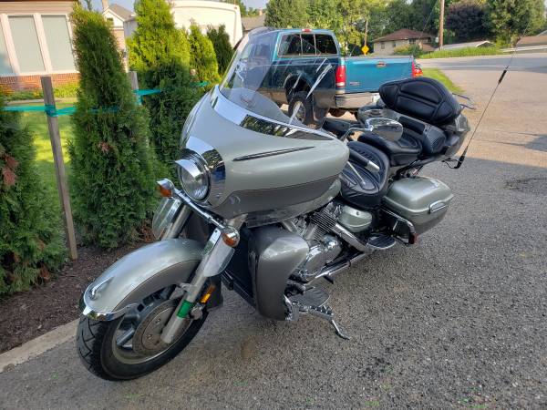

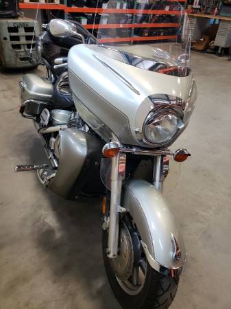

Finally settled up with the insurance after the deer hit us and totalled my 99 Venture. Thanks to Dave for the heads up on another 99 Venture for sale, was surprised with the condition and less than 48,000 miles. Brought it home today before the rain started and began transferring necessary parts to make it comfortable enough to ride the rest of this season. Will make it ours over the winter. Here are a few pictures of the way I bought it. Ron

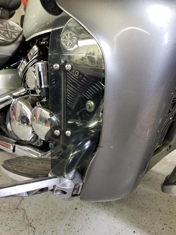

I've been trying to locate replacement lower tinted wind vent replacement, couldn't find any so I made my own. Also Tina wanted passenger pegs to allow different leg positions for long rides. Since diamond R went out of business I decided to make my own. Below are finished photo's of both. Ron
