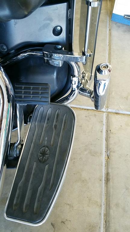

Sorry Steven, I forgot you have the heel/toe mod forward controls. So I deleted my post above. I was explaining further..but that isn't valid now. In your original post, diagram on post 14...where you have a blue arrow you drew to indicate rotation, that is what I was referring to. By rotating that little lever in the linkage, you can easily reverse the shift pattern. I think you will need to make a plate that will allow you to get the proper rotation like @cowpuc was saying in his post to you. Shouldn't be too hard. Or go back to normal shift controls. My apologies....I completely forgot about your controls. -

Reverse shifting. I though you were able to flop that linkage upside down. If I'm thinking about it right, it should be easy. Don't have to take anything off. Just make sure your shift shaft is indexed to the shifter, (The slot of the shaft is indexed to the dot on the shifter) then disconnect...move the assembly upside down and reconnect. Didn't we talk about this earlier or am I "out to lunch"....again! -

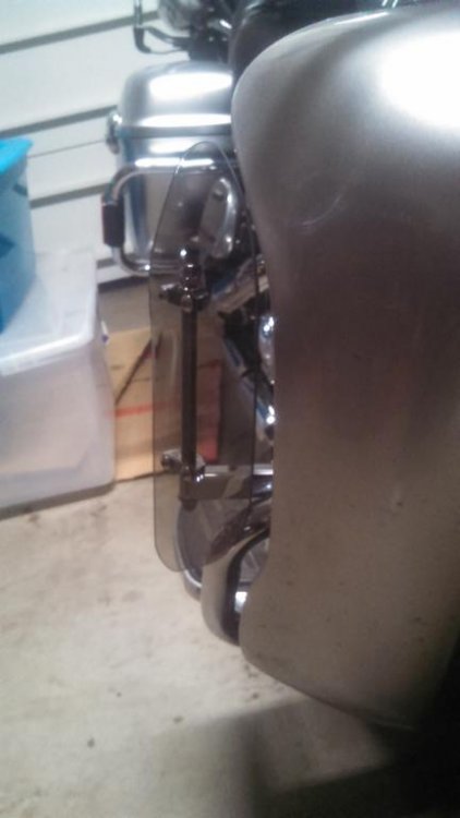

Sorry...I'm not near the bike so I can't take any pictures. But Bob has it right. The vertical round bar holds the vent and allows you to move it in/out. At the bottom it's connected to a flat bar that runs across the engine guard. Another smaller bar mounts opposite it and is bolted to it. At first glance, I didn't think it would hold more than 5 minutes....so I put the strongest tie wrap on it. But it's held up for over a year now without troubles. They were expensive...I think I paid $160 for mine brand new. But they are worth it. The build is top quality befitting a Yamaha product. And with a slight adjustment, mine is easy to change position but still holds it's position despite very heavy winds. I can even change it while on the move....but don't let anyone know I do this! I'll be home next week. If you need a close up picture, just let me know. Found 2 that should help!
