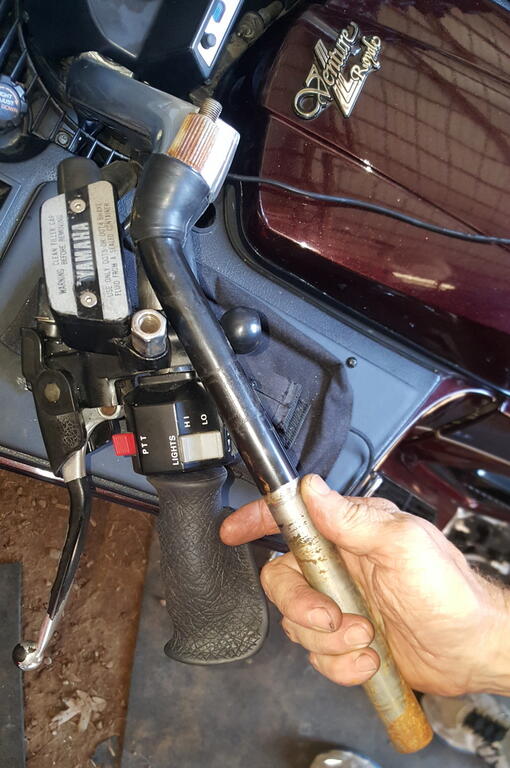

  4. This A generous member donated an extra set of bars several years ago, finally got around to using them. Straightened the bend "quite a bit" with oxy-acetylene and shortened them 2 1/2". Took a couple times to get them adjusted where I was happiest but much better now! Also removed the lead weights, so far that's just fine. Grips are Siligrips my favorites! Also snagged a used Barnett clutch conversion and a new gasket off fleabay. She would only slip at hard throttle above 4500 RPM but I do that sometimes.
