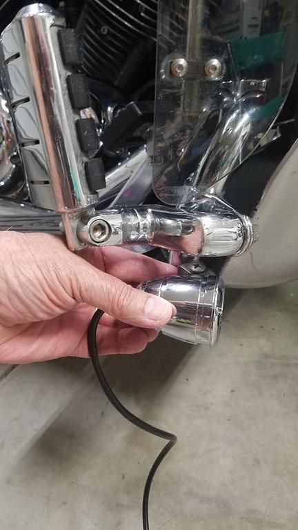

The biggest issue with the 2nd Gen for me is there is no place to do things. Like little pouches or lights! I've explored putting them on the front fender bolt...but can't find a M8x25 bolt with a M4x10 screw hole inside of it. That way I could mount the fender bolt then mount the light to the bolt. The stock bolt is recessed and I'm not to keen on putting a bunch of spacers or washers inside, then use a longer bolt and attach the light bracket there. I know it could work but sure doesn't seem like a good way to do this. Am I making a mountain out of a molehill here??? So went looking for alternatives. I have both the lower vents and the highway pegs on the engine guards...only place left for a light there is underneath. Downside to that is the light output will be lost on the road. Not going to help much locating the dumb deer that want to kamikazi me... Now I could mount the lights on top of the lower fairings. Just drill through plastic, reinforce underneath to stiffen the plastic and mount. Have to put quick disconnects so I can take the fairing off....but at least the lights are up high enough to do some good. But it doesn't look that good! At this point my brain is fried from thinking about this. Have had the lights 2 months and still not happy with any position. Ideas and thoughts appreciated!
