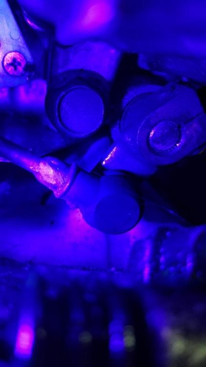

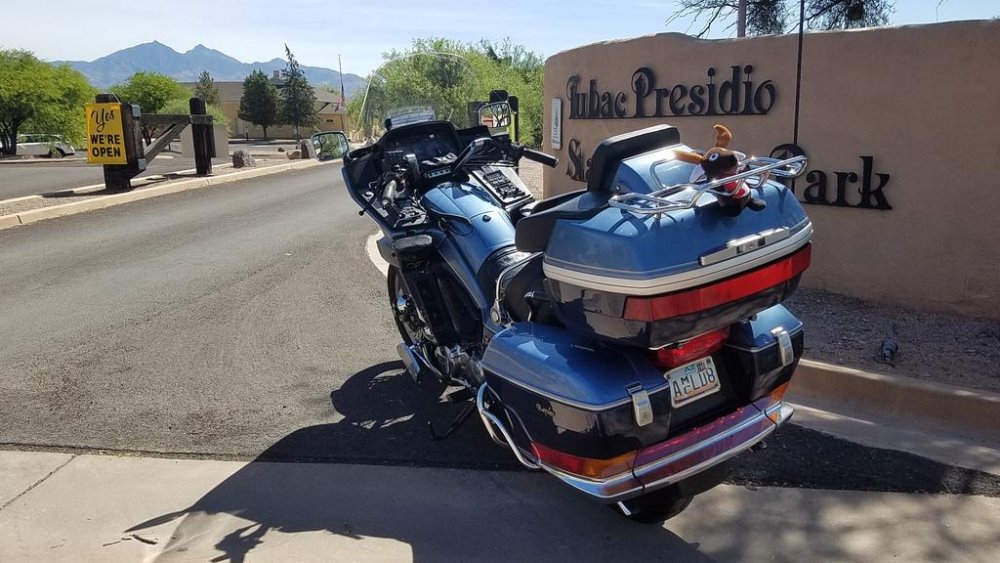

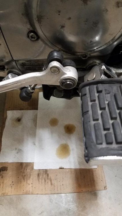

  2. Saturday Update: Went for my morning breakfast ride to Rio Rico. I do like that little diner. On the way back, stopped in some familiar places... on a 2 lane outside of Tubac... 2 views...behind and in front of me... The Presidio at Tubac... And then home.....this is after about 30 minutes after motor shut off.... So you can see the size of the drips and the location. 3 drops on the rear most sheet of paper. The front sheet is a stain from previous fun... I did a preliminary search again near the front of the motor...and along both sides. Nothing. Tomorrow I'll take her apart again...and with lights out...search for the elusive oil leak...

  4. Jeff, it's not leaking that much...just a few drops after a ride. I cleaned the floor last month after I did an oil change on both Ventures....so any oil on there is new stuff from the leak. It's back together....will try to get some riding in this weekend. Maybe a couple of hundred more miles will help me find the leak! Yay...Ride!

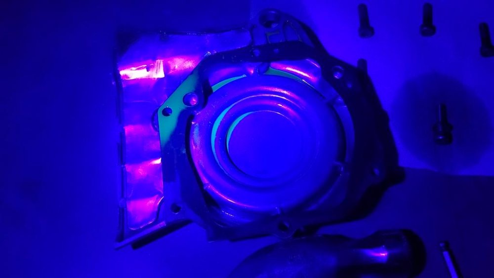

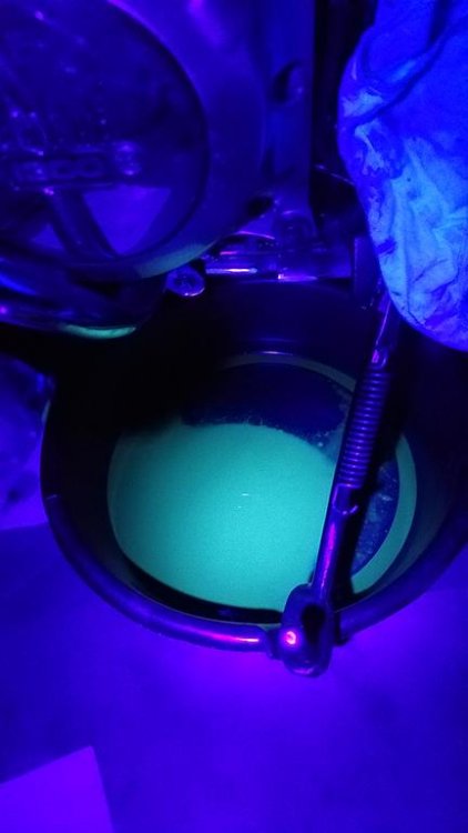

  5. The dye definitely got into all the oil. It drained out a bit when I took off the cover. Look at the green tint from the UV light reflecting off the dye. Can even see it on the cover that I haven't cleaned yet...in the upper left corner of the cover there is still oil there.... I have a feeling I'm going to have to live with it for a while, though I do get tired of the drops on the floor. She marks her spot now, every time I shut her off after a ride. Grrrr...

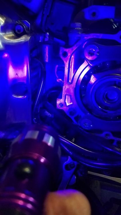

  7. UPDATE: OK..back home in GV. Went for a nice fast ride yesterday to stir up the dye in the oil... Took cover 2 off this morning to look for the pesky leak....nothing. No dye visible on the stator wires, the neutral switch assembly, the clutch slave assembly or the shift shaft. General view looking into the area....BTW, WalMart has the UV flashlight, $10 in the fishing department, it's a small Ray O Vac uses 3 AAA batts and is bright. It will go in my road tool kit for sure. Good for bugs and such as well. Shift shaft area is clean as well..... I turned off all the lights in the garage and looked all over the motor. From the valve covers down...including everything in between. The oil/water "twinkie" area between the cylinders is dry as well. One drop of oil was seen under the rubber cover that covers the U-Joint...but I think that came from oil running back. That area is to far back since my drip is right under the area where the slave/stator wires/neutral switch/shift shaft are. Even under the motor...the pan area...is clean. No green dye seen. So...where do I go looking now? I would appreciate any ideas....

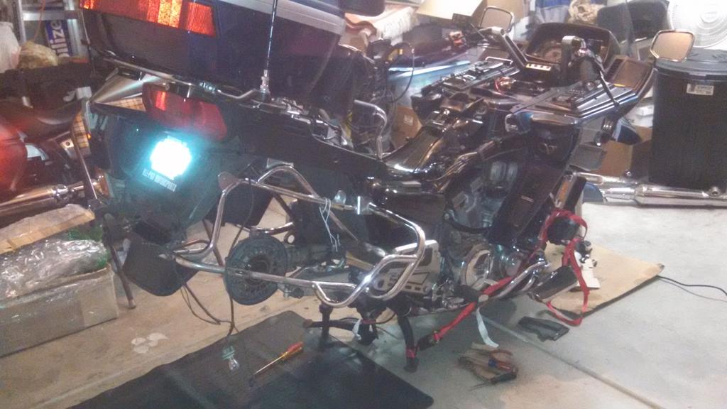

  20. Thank you! And so will yours when you get done. Here is a picture of the first time I took the rear end apart to grease the rear end and found a broken drive piece....Someone on the forum called the position "Kneeling". The front wheel off and the bike resting on the front forks. This gave me room to take off the rear wheel and get in there and clean and grease... I can't believe I did this with very little knowledge of this bike...
