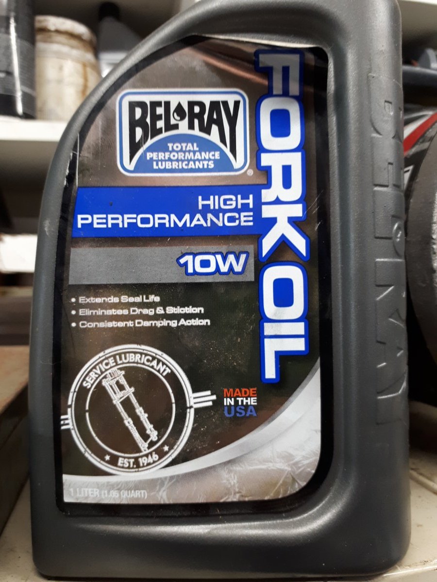

  23. About 3 months ago I repaired both forks on my 83 1200 On oil refill I used a synthetic blend oil by Torco I noticed a leak on one fork about 4 days ago , and I drained the oil and it came out black and ugly I have flushed the fork 4 times now and will flush it again on July 22 . The bike has not been run for at least 3 months and I don't understand why the oil would turn black with the bike sitting Have heard some comments about the seals not being compatible with synthetic blend oil I hope some can explain why the oil would turn to a dark black
  24. @saddlebum ..what you think about using synthetic fork in the 83 Venture front forks ..
    I did a repair on my forks on my Venture and I did use synthetic fork oil on refill ...
    I noticed a leak coming from bottom of the fork , the bike sat for 3 months and has not be on the road .
    The drained the oil to repair the leak , and it was black , black ,black .
    I then flushed fork 3 times with little improvement on color , would you use synthetic oil or non synthetic fork oil
    And is there a compatibility problem with oil and seals
    1. saddlebum
      saddlebum
      To be honest I have never used synthetic fork oil so I really can,t say much about it. As a rule i do not tend to lean towards synthetics as I believe oil does not wear out but gets dirty. A fact pointed out to me by a Shell research worker I once knew. Having gotten over 300,000 miles on many engine on Dino oil and often running oil 4 times as long as recommended only changing the filter regularly I see no point in the added expense. Plus I find in these old bikes as I did try synthetic once in my 89 that the engine is much noisier on synthetic than on regular Dino oil which seems to do a better cushioning effect on the moving parts were lash is involved
      My personal favorite for the forks  is Bel Ray, Have been using it since my motocross days in the late sixties on all my bikes. On my bike I use the high performance 10W20210722_180509.thumb.jpg.d0aa4f67a90b2a762a70c1edc8b19b5e.jpg
