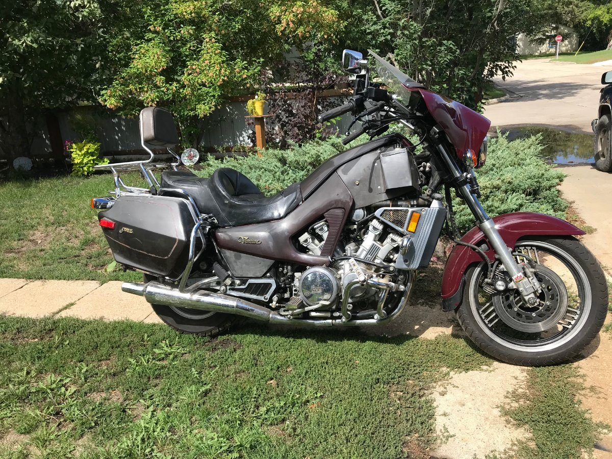

  9. I found the 83 hard to handle / balance , and I am 5 foot 5 and had a hard time reaching the ground . I removed the rear trunk and the front fairing ...I relocated the relays to under the seat ,and lowered the rear of the bike 1 1/2 inches by relocating the shock pin by 1/2 inch ..I had to cut the side stand by 1 inch , and remove the center stand ..I installed 120 70 r 18 at the front . I removed 65 lbs from the bike and it does balance easy ...I can grab one handle bar with one hand and lean the bike 12 to 14 inches bring it back with one hand easily ...

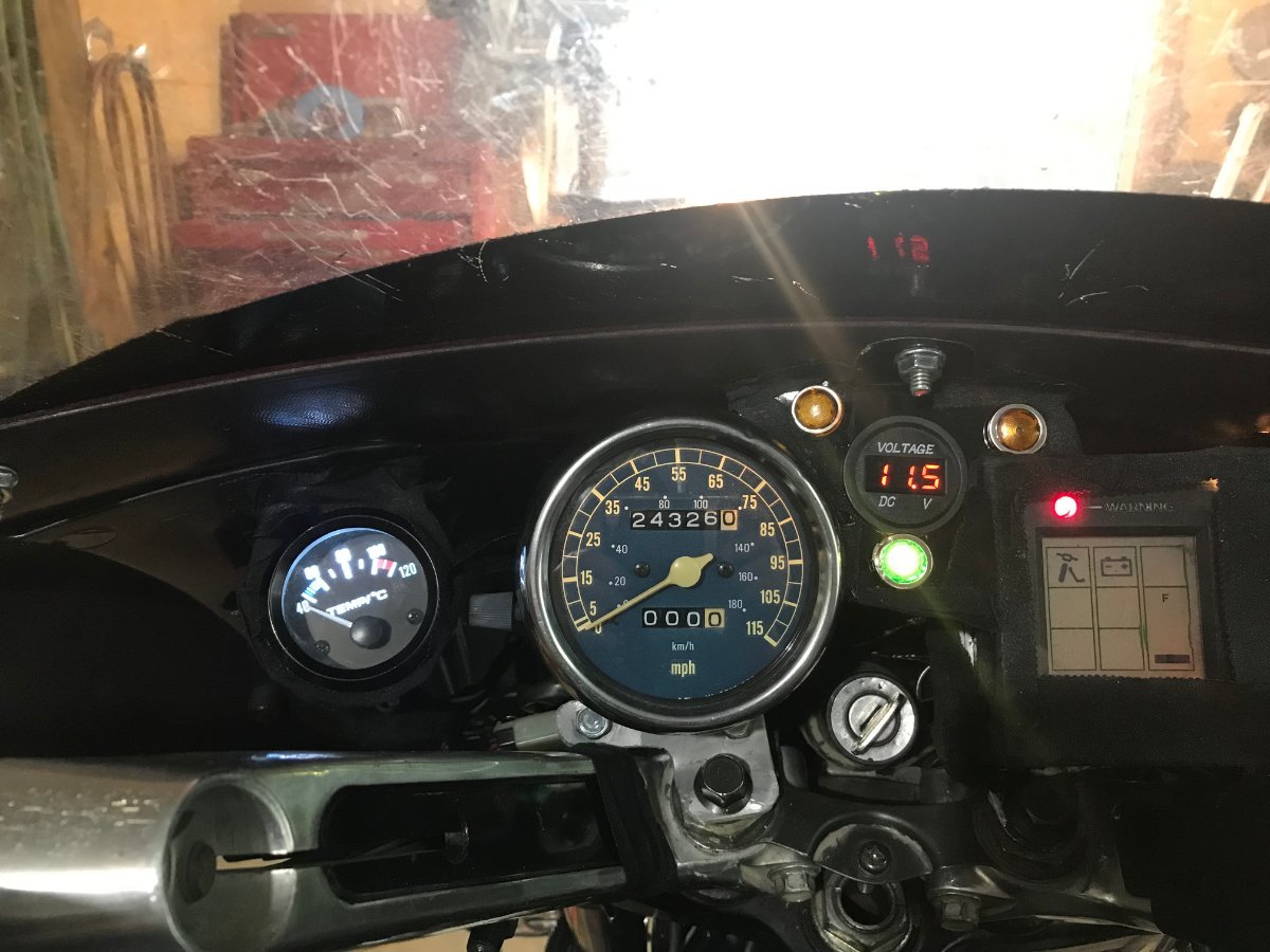

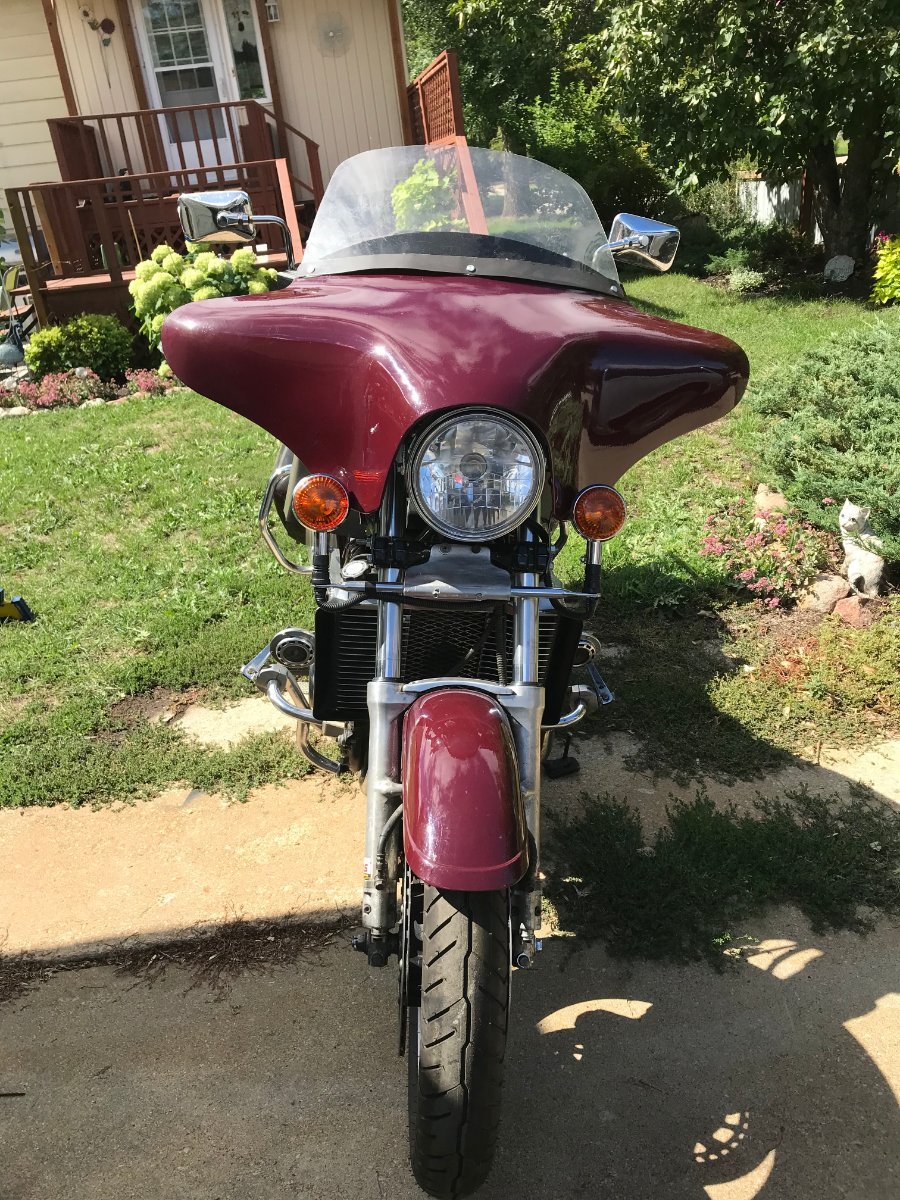

  12. I have removed the original front faring components to bring the weight down on the bike ...I have moved all the relays to under the seat and installed a Bat Wing and windshield with smaller version of dash components .. Because I mounted the coolant recovery directly to side of the bike .. I am trying to figure out a smaller version of a coolant recovery can for my 83 XVZ1200 ...To make up a smaller version of the recovery tank is easier said then done ..Had some thoughts of making one out of a 3 inch round tube to mount on the side of the bike near the rad . Appearance is something everyone will comment on

  21. i spent many months going over the bike front to back Repair .....Forks , Steering head , brakes , Changing system (New Stator ), new tires 102 70 R18 on the front ,,,Removed faring , removed rear Trunk , removed 65 lbs ,, Installed a back rest at the rear ,,I moved all the relays to under the seat ,,, I repined the center shock by 1/2 ., to raise the rear wheel and lower the bike by 1 1/2 inches ...My feet are flat on the ground ..I have 5 inches clearance about the rear wheel and 5 inches of ground clearance at 15 PSI on the rear/center shock 20 psi will increase the ground clearance to 6 inches ,,,still lots to do , I need to find a better place for coolant recovery can ,, then repaint the bikecrease the ground to 6 inches .

  23. @JFootman ...I finished 10 months of work on my 83 ...Started with the front forks, new tire,,,120 70 R18 , steering head bearings , brakes & hydraulic cylinders , hoses , new rear tire , 150 80 R16 , clutch basket , new Stator , oil leaks , relocated relays to under the seat , removed the front fairing , mounted a new Batwing to cut down on weight , mounted new gauges , cut the seat 1 1/2 inches , repined the center shock 1/2 inch to drop the rear of the bike 1 1/2 inches , removed the rear trunk and installed a back rest and I will be moving the battery down in the rear in front of saddle bags 1 on the left and 1 on the right , the 2 batteries together will equal the cranking power of the one larger one .I am about 85 percent done now ....I will post pictures of the bike with the changes soon ....The bike weights 70 lbs less now . and sits 1 1/2 inches lower now at 15 psi in the center shock and 20 psi brings the bike up and inch higher
