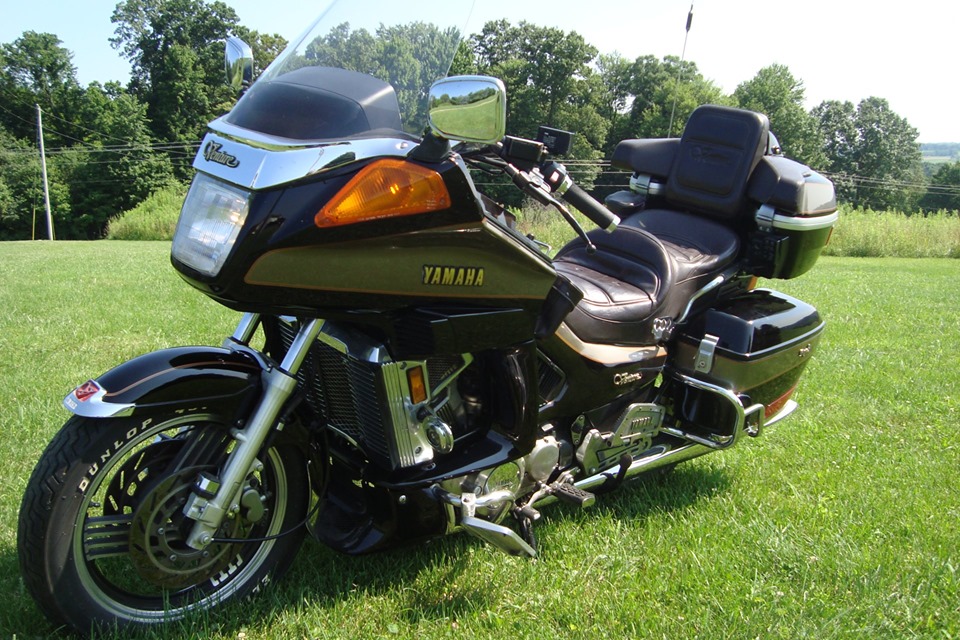

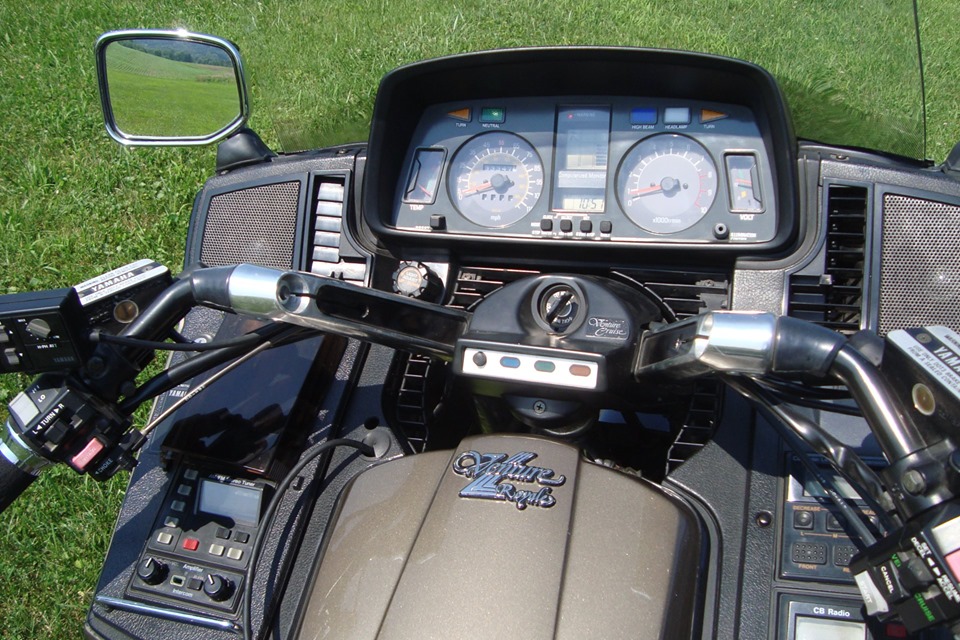

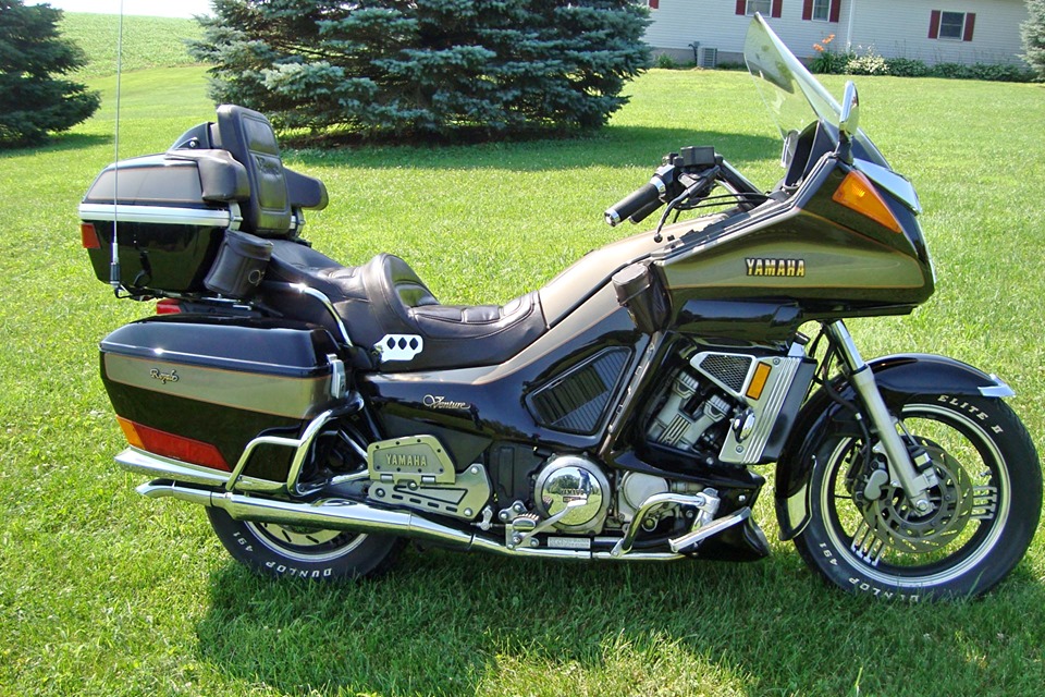

luvmy40 Posted July 14, 2019 Posted July 14, 2019 First things first. I just brought this beauty home tonight! Let me tell you, this is as close to mint as a bike this old with any mileage(33K) could possibly be! I see two scratches that are even noticeable and the vents on the side covers have some cracks. But they are there and complete. That's it! The paint is nearly perfect(those two scratches I mentioned) and everything is operational. It even came with two paint matched helmets with the factory intercom system, the factory service manual, the original owner's manual, the original tool kit and all the pads in the bags. The two scratches are on the left side bag cover where it fell from the seat once. Technically I'm the fourth owner, though the third only owned it for a little over a week and never transferred the title so I am legally speaking the third owner. The second owner is in his late seventies and bought from his friend in 1999 with 9594 miles on the clock. I had seen this bike posted on Facebook Market Place a few weeks ago for $2000.00 but did not respond as the one picture looked too good to be true(ask me about my experiences in that realm sometime) and the description was along the lines of "looks nice, runs good". I just wrote it off. The guy I bought it from did respond to that FB add and brought it home with the intent to resell it as he is a Gold Wing guy. I gave him $2300.00, after all he rode it the 100 miles or so from Tiffan to Perry making a shorter trip for me to pick it up. He did say that the CLASS works but shows E4 error? I know I've seen some talk about this here, I just don't remember what it means. Any way, to say I am happy with this find would be quite the understatement!

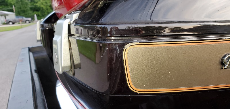

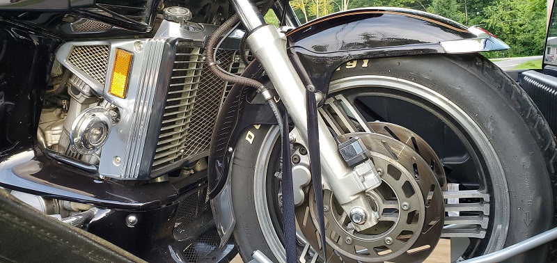

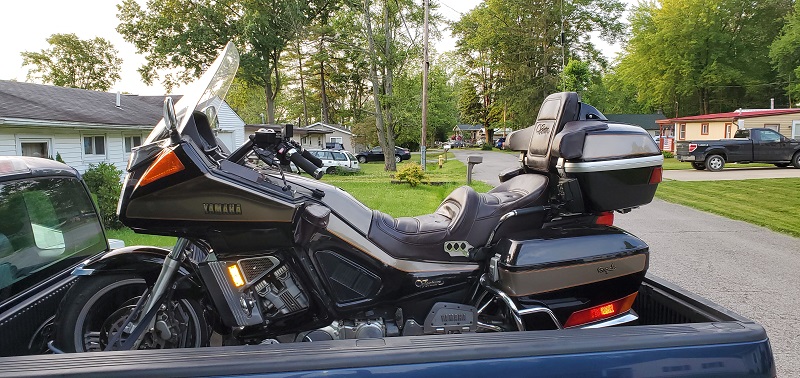

luvmy40 Posted July 14, 2019 Author Posted July 14, 2019 Yes! I am very glad that I kept looking! Thanks for emotional support from everyone who listened to me whine about my trials and tribulations in the world of Face Book and Craig's List! The pics above are from the PO's FB posting as I forgot to take any before we loaded her up and it was too dark for photos when I got her home. I went out first thing this morning and got some pics of her on the truck. If you look closely at the pics of the side bags you can see on left bag almost in the reflective flash a scratch about 2-1/2" long and one just ahead and above that about 1/2" long. On the right side bag you can see the back, top corrner of the pin stripe is chipped and there is a tiny scuff just below that. That is the worst damage to the paint I can find. Now, I have experienced the "New Bike Goggles" phenomenon before. I know I'll find more of the like as the newness wears off. But I doubt I'll find any cosmetic issues wose than those I've pointed out. She's just that perfect! Three things make for this not being the absolute perfect bike for us, and they are minor I know. 1. The back rest pad is black and faded. It was obviously bought later and did not come the bike from the factory. The back rest mounting hardware, just as obviously DID come with the factory package. I can only assume the original was lost or damaged somehow. 2. She does not have a luggage rack on the trunk lid. 3. She does not have a trailer hitch. All can be easily remedied. She was cold in an air conditioned shop when I arrived and started right up with no enrichment with just the slightest bump of the start button. I did not even take a ride, except to run her up the ramp onto the truck. My grin was so wide the seller knew he could add some $ to price and I would have just said OK and start counting! I fully expected another situation where the pictures were old and the bike was a shadow her former glory and got exactly the opposite. The picture didn't do her justice. OK, I'll shut up about my good fortune...for a while. :banana::banana::banana::banana::banana::banana::banana::banana::banana::banana::banana::banana:
