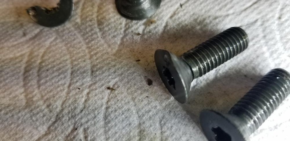

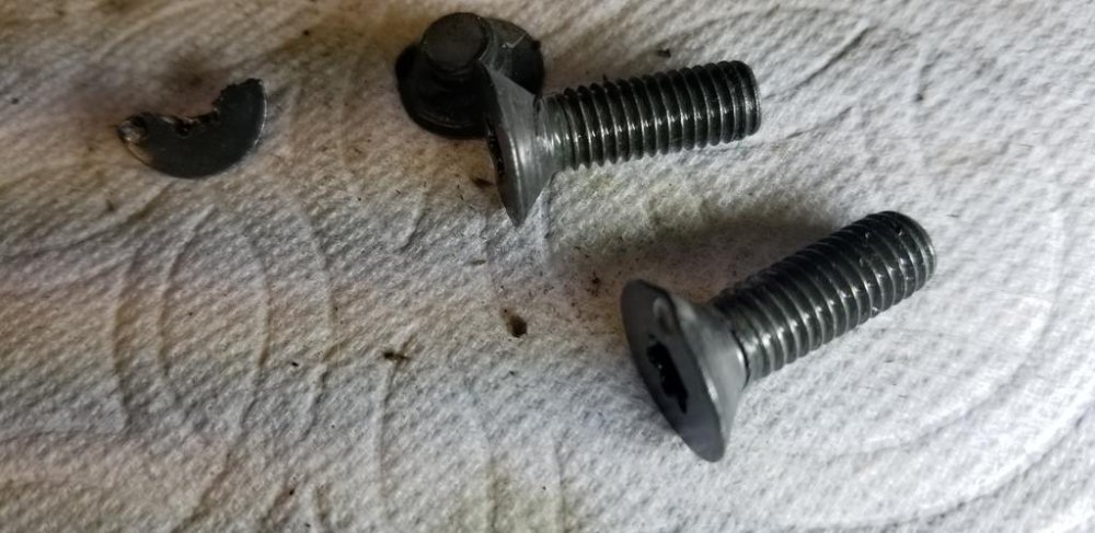

sleadhed Posted April 29, 2019 Author #20 Posted April 29, 2019 Well as it turns out there were two different knocking noises in the engine. The worst one was the tapered bolts with the torx heads that secure the plates for the middle gear shaft on the left side of transmission. There are 4 total one on each end of the two bearing retaining plates. they are staked in to place. the head of one of the bolts (technically tapered cap screws) cracked and fell off at the head from the impact of being staked. I know this because 3 of the 4 have visible cracks when removed. I drilled out and extracted the one that broke off in the engine and replaced them. This time I used red lock tight and let it cure overnight before reinstalling the left rear side cover and filling with oil. (See attached photos of bolts) After starting, the real horrible knocking was gone but there was still another noise. So at this point I decided screw it got an engine from pinwall with 20K swapped my high output stator and barnett clutch, checked the middle gear tapered cap screws that broke off on my original engine and guess what? They were starting to develop cracking at the base of the tapered head on two of the bolts. they were all replaced and red lock tighted in to place. For those that have been here since 2007 that know I was fighting a misfire under load (basically freeway cruising speed) just after it hit about 1000 miles. You may recall I hat it to two different dealers multiple times each to get this resolved within the warranty. Neither of the two dealers were competent enough to diagnose and resolve the issue. so at 9000 miles I began testing and isolated the #1 ignition coil breaking down under load. All 4 coils were replaced at that time on my dime because I had lost all confidence in any of the dealers ever touching my bike again. Well due to the fact that there was no spark in #1 under load and cruising speed for 8000 miles the cylinder got washed out and I had a weak hole even after correcting the failing coil. (this is all theory at this point, I have not yet torn in to original engine) The 20K engine RIPS!!! this bike has not pulled like that since early 2008 right after I bought it. Sorry for the long post and rant but just wanted to let you all know the out come. Also wanted to warn others of what I found on the middle gear tapered cap screws on both engines. I will post updates of what I find on my original engine when I get around to tearing it down and rebuilding it.

sleadhed Posted April 30, 2019 Author #25 Posted April 30, 2019 I have to agree with cowpuc that noise definitely sounds valve train speed. Try to isolate it more on the valve covers with a stethoscope or if you do not have a stethoscope use a long screwdriver, Place the tip of the screwdriver on the area you want to hear better the rest your ear on the end of the handle of the screwdriver. Also when one of the center gear bearing retainer bolt heads break off the noise is not rhythmic wit RPM's like yours it is very sporadic. Good luck Ken
