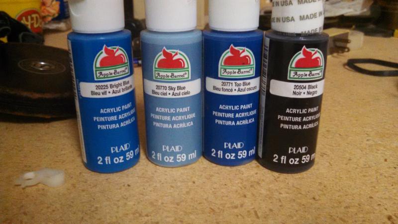

videoarizona Posted December 17, 2014 Posted December 17, 2014 I went to WalMart and bought these craft touchup paints in craft area. $.50. So far I haven't matched color perfectly. Trying different mixes of colors. May just go with the black on right on both sides.....
