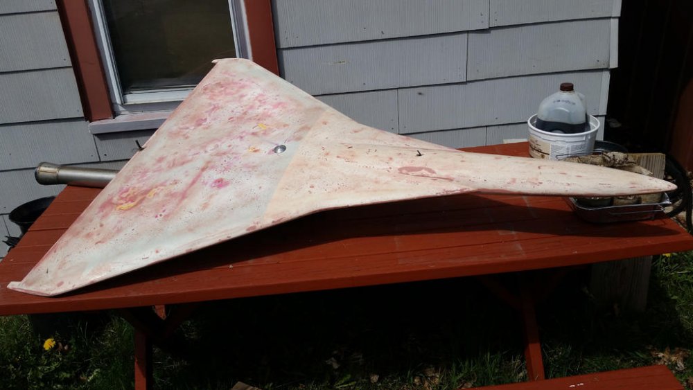

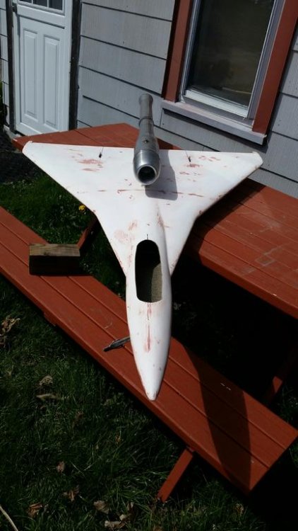

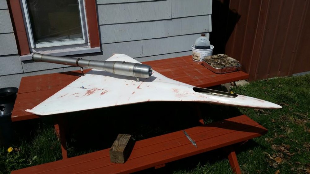

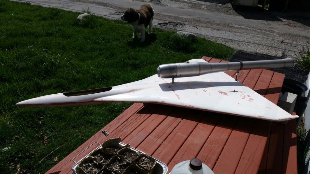

Well here are a few pics to wet your appetite. It sure does not look a lot different from when I started, but there is a lot of time wrapped up in it already, most was filling and sanding and the early parts of paint prep. The pulse jet is just temporarily mounted to get a rough idea on where the CG is headed. It looks like everything needs to be as far forward as it can go and I will still need a lot of lead in the nose. This also means that there is no reason to skimp on any structure up front. @cowpuc -
