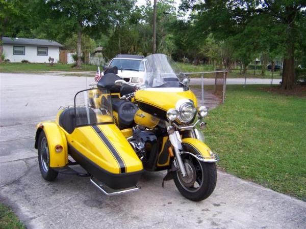

hello any good body shop. make sure thay use good paint basecoat & clear coat. as far as price call around the biggiest thing is the removeovel of the stripes. when i painted the bumble bee it took alot of time and priming to fix the stripes ware you could not tell thay where there and black will shop all imperfections. if i had a place to do it i would. but not any place at this time. look at my profile for pictures of the bee i painted bumble bee 1999 rsv

bump roadminge asked to see photos of the bumble bee hope you like bumble bee
