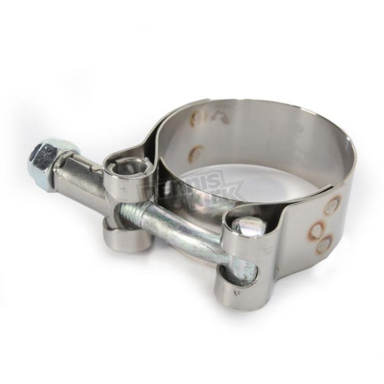

I did find some help for those who may be planning to rework a collector. The only clamps I could salvage were the two on the mufflers, the other four were trash with the bolts badly rust locked. I have great hopes that these new clamps will be easier to get a socket on the nut since it projects out there. I also think that they will seal better than the originals because they have a band throughout the full circle. The Cobra 95-2950 1.5" stainless exhaust clamp is a great deal at $6.98 from Dennis Kirk https://www.denniskirk.com/cobra/stainless-t-bolt-exhaust-clamp.p442692.prd/442693.sku I need some stainless tubing to recreate the rear sockets since it seems that is where my leak was. The existing metal is so thin as to be nearly gone and it's distorted somewhat as well. Grainger has a closeout on 1.5" OD stainless tubing, 1 ft @ $13.20 2FGF5 Tubing,Sanitary,1 1/2 In OD,316L SS,1 Ft 1.00 EA 13.20 13.20 I measured about 1.25" or close to 33mm for the front pipes and the rear nipples. The sockets these fit into are as much as 1.5" inside or between 36mm and 38mm. There is still a little of the seal material I didn't disturb and so I only measured the upper areas beyond the seals. The tubing I will use to repair the damaged sockets is stated to be 1.37" ID and 1.5" OD. Outside of those sockets where the clamp goes are around 1.5" but there's corrosion and it flares a little wider above the clamp area. The output ends where the mufflers go are about 1.5" and the sockets on the mufflers are about 1.75". There's roughly .25" of difference that the seals account for in each of these connections. I plan to use high temp copper silicone to seal each of the connections inside and leave it to cure for several days before starting it. Why am I telling you this? So you can tell me a better way or congratulate me on a good plan. One way or another, let's hear it? -
