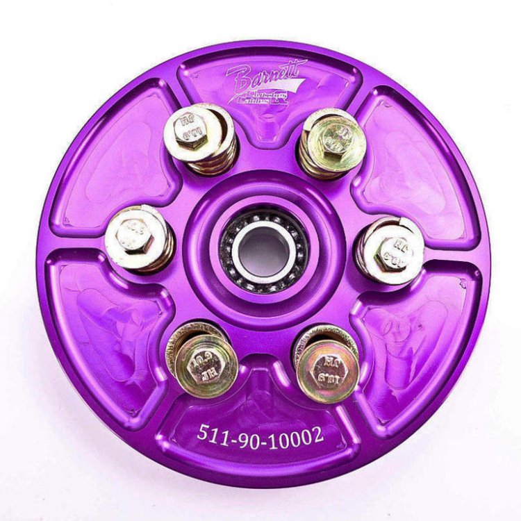

Been very happy with my '09 RSV trike. It served me well for 51K miles. Returned from a 12 day trip a couple weeks ago, and problems surfaced. For one thing, drove in darkness and light rain anticipating heaver rain. It never came. In the darkness, hit a few potholes with my right rear tire. About a mile from home, noticed loss of power, and kept working throttle to get home. Was able to drive trike into its shed. When I tried to move trike a week later, it idled okay but stalled every time I tried to let out the clutch, even if I revved the engine. Put trike away and looked at it another day. Noticed relay engaged but fuel pump did not click anymore. Changed fuel pump points with no luck. Ordered new fuel pump and installed it today. Fuel pump clicks again. However, stalling issue is still there. Trike tries to lunge forward and dies. I have the Barnett clutch spring upgrade. Does this sound like a clutch issue? Trike has climbed many mountains all over this country, so I would not be surprised. Thanks!

https://www.ebay.com/p/Barnett-511-90-10002-Clutch-Spring-Conversion-Kit/171263698?iid=261700666860 -
