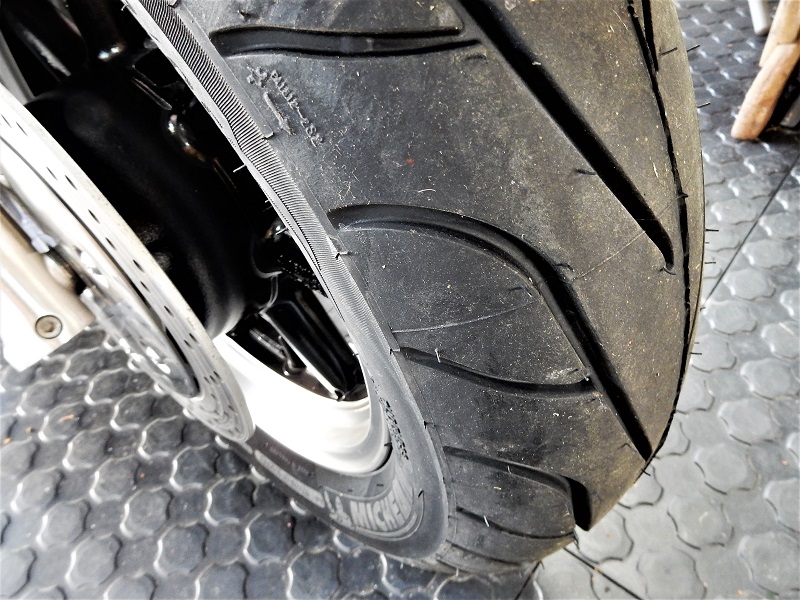

	Use rear motorcycle tires on front of my trike. Feeling is rear tires are more durable with increased load. All tires cup on front of my trike on very twisty roads, but they flatten out again on highways. Use Ride-On tire sealant to help with rebalancing. Right now using Michelin Commander II rear tire that has seen 29 states coast-to-coast and down the Blue Ridge Parkway from NJ. Still looks great! Have had tires mounted both forward and reverse, but found no difference. Commander is mounted in forward direction.

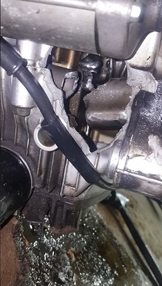

That's the result of a gas explosion in the engine. -
