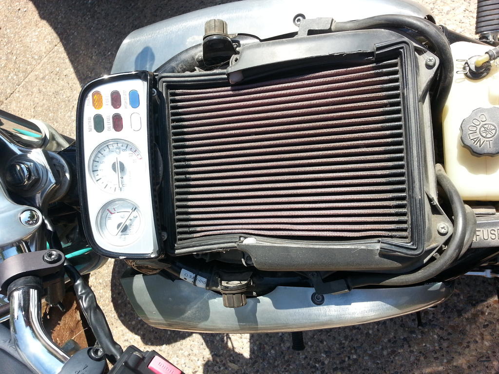

Pods, for some reason I was thinking a drop-in, sorry. Yea, I would start with the air correctors or getting an OEM airbox and filter. I got my correctors from Morleys Muscle, ya just tap them in and seat them. You can remove them later but are not reusable after removed. Just four little brass thingies and my guess is you will be happy, as you would be if you found an OEM airbox. Either way and I'm pretty sure you will see a real improvement. http://www.morleysmuscle.com/ I'll bet he has some in stock. I tuned my Vmax with all his stuff and I'm pretty darn pleased with it. -
HELP. Idle poping and coughing
CaseyJ955 replied to Rilcoat's topic in Royal Star Venture Tech Talk ('99 - '13)
Just for fun, if you have the paper OEM air filter go ahead and throw that in and see what happens. The K&N may not be providing enough resistance to flow, the CV carbs rely on that to run right. There is a workaround for this, but try that first and see if it goes in the right direction. A workaround, if this turns out to be related to the air filter being to free flowing. See the extra brass bit next to the jet, ya get those and slip them in and they fool the carb into playing nice with a free flowing air filter. Here is a pic of the filter that replaces the lid on my Vmax (Same as Venture carbs). I think the plugs are like $20 from Morleys Muscle. When I tried a K&N in my Venture I ended up going back to paper OEM filter. Food for thought. -

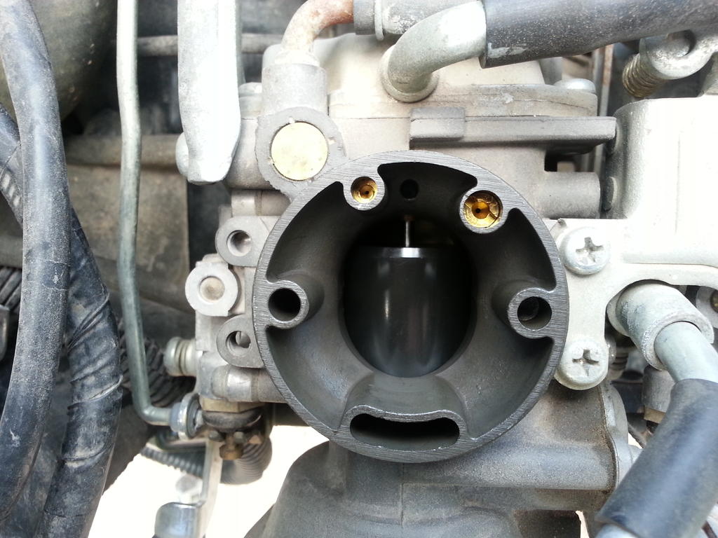

I've done this a time or two on the Vmax, it often works, sometimes not. On the Vmax the carbs can be pulled in about 15 min, on the Venture it's a bit more of a knuckle buster so we'll hope the Shotgun method works. The ride-ability symptoms match plugged jets pretty nicely. As your doing the Shotgun method please note that any time the airbox lid or filter is NOT securely in place it will run like ****, this is normal with the CV carbs as they rely on the intake restriction to run correctly. This wont help you right now but one way to avoid problems with carbs is to avidly avoid ethanol tainted fuels. When I must use it it seems okay if I'm touring and I ride every day, but I do use a couple oz of Seafoam with each tank and before I park it for any length of time (esp over winter) I make sure and run enough pure gasoline through it to flush the ethanol from the fuel system. By following this I've not had to futz with the carbs in a long while, other than synchronizing 1-2 times a season just to keep it crisp and snappy. I hope the shotgun works, keep us posted.

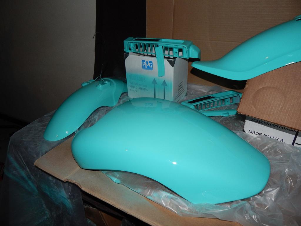

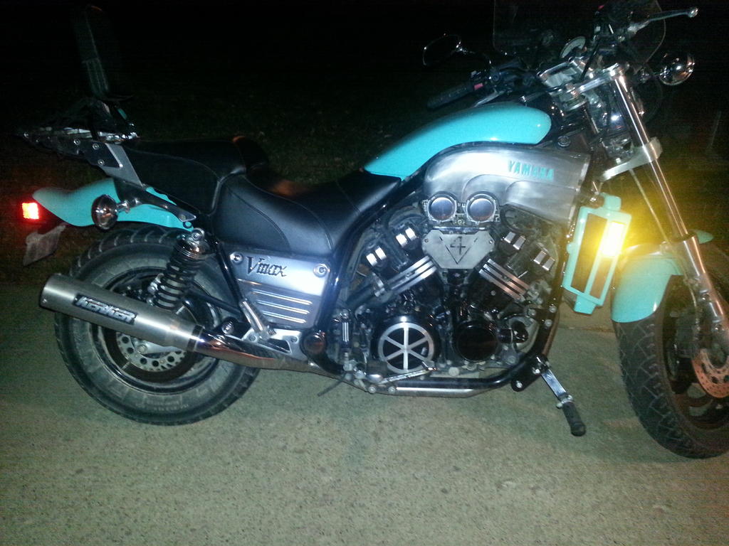

Gray has a lot of range, I'd go that way. Any shades of tan or brown will probably make it look like you sideswiped a 74 LTD Country Squire Woodie. I painted my Vmax for two reasons, first I wanted a safer color than flat black, and I wanted a color that nobody else on the Vmax forum had. I choose a Turquoise and it came out a little lighter than I had hoped, but after I saw it in the sunlight I decided it was just about right. I have never seen a Vmax quite like mine, which was a large part of the point. I have never painted before, not seriously anyway. I went to a body shop and picked out the color and they put it in some spray cans that worked almost eerily well to lay the primer and color down, then I used a can (Probably two cans for a Venture) Eastwood/2k two part clear coat. It comes in the can also but has a bladder inside, when your ready to use it you just hit the button on the bottom to mix the two parts then you have a clock on getting it applied. It worked very well, I'm surprised by the results. Just like on cars, all the work is in the prep. On that clear coat, your going to want to breathe about 0% of that nasty crap, it's wicked toxic so ventilation and a resp would be great ideas for spraying that stuff. All and all it was very easy to work with and although it took a little more time and money than I wanted it's been years and the results are quite lasting. I like the gray idea, IMHO all the Germans have mastered making gray, silver, charcoal and gun metal very sexy exterior colors. Go for it. If you have trouble finding just the right shade try the BMW, MB and VAG (VW-Audi Group) colors. I think it's a great idea.
I sport a 1st gen Vmax, have spent a bit of time tuning it and get it dialed in. Missing and breaking up over 4k sure sounds to me like it's rich rather than lean. It's a very common Vmax thing, they come from the factory rich. Mine was so rich when I got it that I had to tune it from scratch, especially for my 4000' altitude. 25 mpg is another indication of a very rich mixture, I think most folks here get mid to high 30s US gal. I got my Vmax from about 25 mpg to 40-ish just by changing out some jetts and making sure the float levels were spot on. That 4k rpm stumble is all to familiar to me. Do you smell raw unburned fuel around the bike? I could on mine when I stopped but I knew it was an issue when someone I was riding in front of was telling me that the rich smell was very strong. Once I got it tuned and leaned out a bit the "Vmax thing" started happening in spades. 4k rpm is about when the slides lift the needles and open up the main circuit so when the main jets are to fat it will begin the rich stumble right at that RPM. Just lookign into my crystal ball here but I'm going to bet your jetting is off a bit, as was not uncommon that some of the Dynojet stage 1 kits for Vmax were way way way to rich if installed according to the included literature. These V4s prefer a tad lean over a being rich, and it seems most of them I have had anything to do with were much to rich, which cuts into the Vmax experience. Vmax main jets are pretty fat from the factory, I'm running a free flowing Kerker exhaust and Morleys intake, my jets are smaller than factory and it pulls hard all the way to the 10k redline. I'm with puc, we need as much info as we can get on what the setup is, BUT it sounds like your tuning a Vmax and not a Venture. When your pulling the carbs (Its sounding like thats where this is going) it might be a bear, even with factory intakes it is a tight squeeze, but with the slightly taller Vboost manifolds you may end up having to lower the engine, i've not done this but I've read about it enough times that it resonates as I'm ready to do a Vmax head/cam swap into my Venture. When you get the carbs apart make notes of all the jet sizes, I'm really interested in the main jet sizes. Also note that the factory jets are Mikuni, and most of the aftermarket jets are DJ, the size numbering DO NOT coorelate, there is a conversion chart here so that when you do get it apart you can make better sense of what you really have. Another thing that may have happened since that Vmax engine has been on the planet for so many years is, someone may have put in aftermarket needles, these MUST be identified before we can talk about jetting. Luckily there is a picture that IDs the commonly used needles in these applications. Stage 1 DJ needles are not fun to work with, there are better ones to use. I have the pic but cant post it, but if we can see your needles we should be able to identify them. I think factory Vmax main jets are 152.5 MK, I'm at a 147 MK main and it pulls like a beast with no more stumble or flat spots. Whats right for you will depend on needles, exhaust, altitude et al. https://yamaha-enduros.com/index.php/workshop/carb-jet-conversion-chart Another word of caution, dont hurry to buy carb kits and parts, there are good parts and bad ones out there, best rule of thumb is NEVER put Chinese parts on a Japanese bike. Luckily there are some Japanese aftermarket carb parts/kits that are known good and cheaper than OEM. Also diaphragm sets can be had out of the UK for around 100/set and are made in the UK. Beware of the unbranded cheap-o stuff with these carbs. It's fairly common for Chinese kits to be used and the job must be redone with quality parts. Save your $$ and untold aggravation and buy the right stuff the first time around. I know Puc mentioned this, but it's going to be important to see if you have all the components of a functioning Vboost. Yup, pics! This is a link that has proven very useful as I set the floats for my Venture and Vmax (same setting). Good reading. http://www.factorypro.com/Prod_Pages/prody11.html Tuning can be monotonous, especially if you have to try a couple different main jets, but the results are very nice. Congrats on the cool project!
