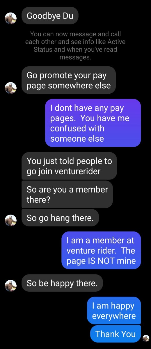

I will tell you the guy that wrote the message to me was Sonny Rattan. Yes, no warnings, (Dont do that again or anything) just bye....
Ya know...I thought we were all in this together... (not on the FB group I guess)

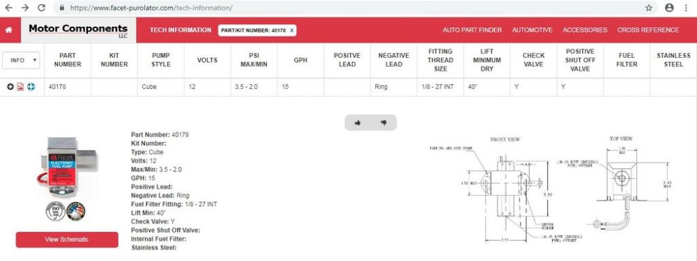

To try and clear this up..... I do not work for Facet or Edelbrock. The Edelbrock 17303 fuel pump is an in-line rotor and vane pump and DOES NOT HAVE A CHECK VALVE OR POSITIVE SHUTOFF. Click Here for Edelbrock 17303 specs The Edelbrock 17303 is a pump style similar to the Facet Posi-Flo series of pumps which also does not have a check valve or positive shut off Click Here for Facet Posi-Flow fuel pump The Facet fuel pump you want that does have a check valve and a positive shutoff is the Model # 40178 Click Here For Facet CUBE Pump -

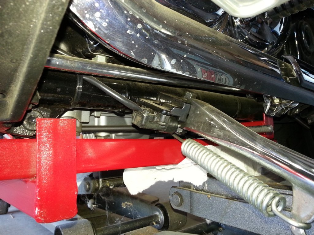

You are looking for a BLUE connector that has a black wire and a blue wire with a white strip on it. There may be a pigtail connector on the left lower foot cowling, otherwise the book shows that it is under the tank (easier if you just trace from kickstand switch through lower left foot cowl once it is off . However, I am still thinking fuse or bad ground (cause it is easier, and it at one time cranked recently). Also, the bike does not care about the position of the kickstand as long as you are in neutral and of course the neutral switch is working. Did you get the Service Manual from here yet?

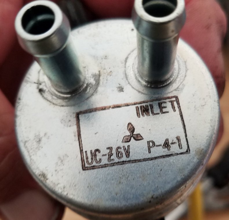

Does the pump have power? Fuel relay will only supply power for about 10 seconds till Engine Startup is detected. Then power is on all the time. Does fuel relay have power and then does power make it to pump. Is the fuel petcock on? If you are vacuum locked the pump will not pump. Same goes for pinched fuel lines. Points are bad. With bad point ...well... you already know that. These are the main things with the fuel pump. There is the service manual on here that has the full diags steps.

The OEM Fuel pump is marked. If yours is not, with the pump held facing you with the tubes in the top quadrant position, the INLET will be on the right.

Well...if you dont want to replace the points, and OEM is not a requirement like he wanted above, I prefer the Facet 40178
