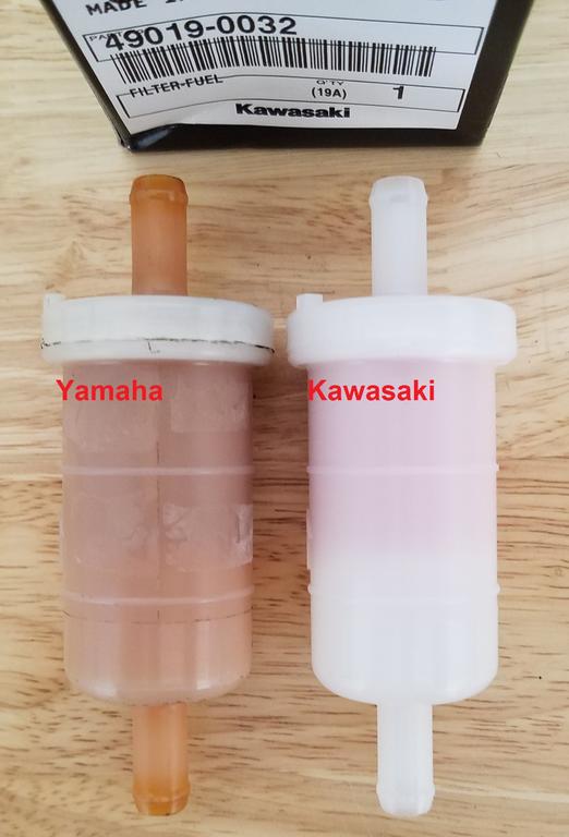

RSV Fuel Filter by Kawasaki 49019-0032
Du-Rron replied to Du-Rron's topic in Royal Star Venture Tech Talk ('99 - '13)

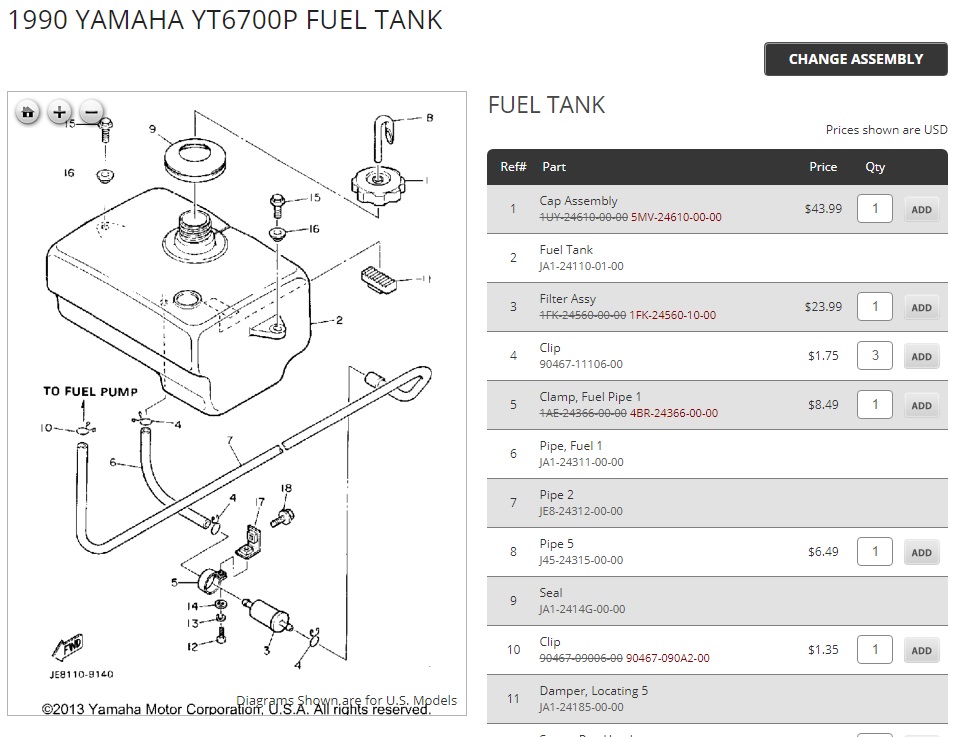

Yeah... the factory Yamaha filter for the RSV, the 1FK-24560-10-00, also goes onto all sorts of Yamaha motorcycles and their lawn equipment as well... -
If you have a multi-brand dealer there is a good chance they will stock the Kawasaki 49019-0032 filter which is the same filter for the Yamaha Royal Star Venture. The Kawasaki filter lists for a couple of dollars less. If you do some business with your dealer there is a good chance you can get it for less than what you would pay on-line even including tax. If you are into Kawasaki Lawn equipment, they are on all Kawasaki FD type engines so you can get the fuel filters for your Yamaha from Kawasaki implement dealers as well. Kawasaki Part number 49019-0032 remains the same across the board.
