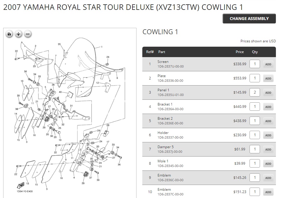

What farings fit a ´96 Royal Star
Du-Rron replied to svebbe's topic in Royal Star and Royal Star Tour Deluxe Tech Talk
The windshields are different. If you got the whole kit from a 2007 including mounts, it would then fit your 96. -

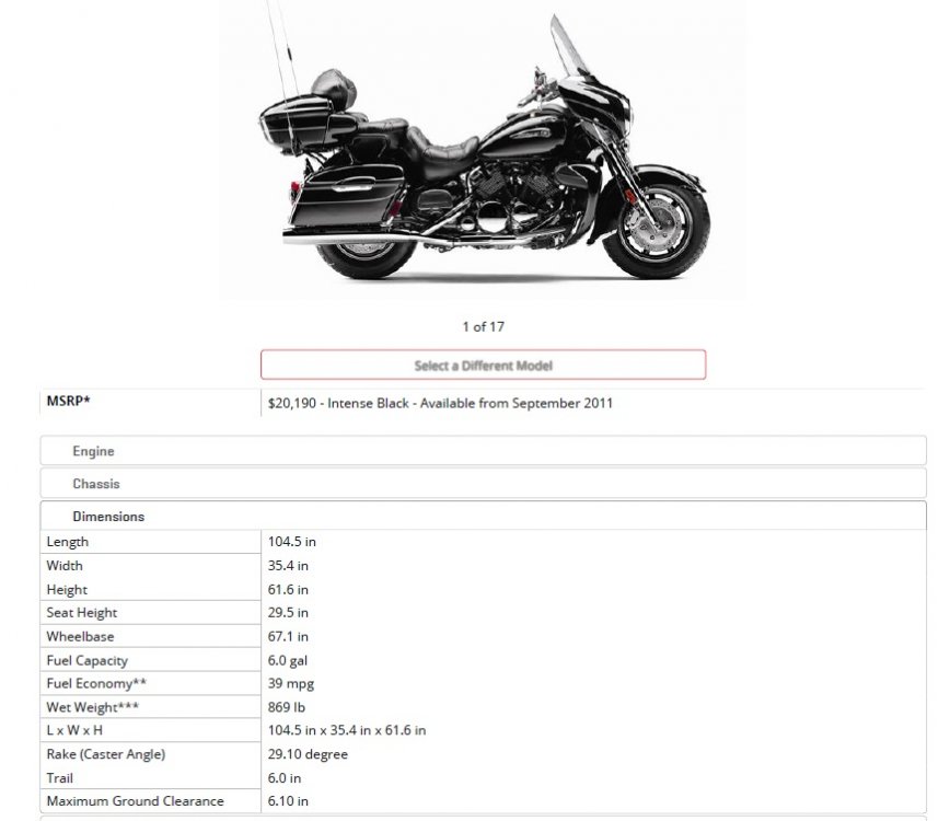

Nope. Your engine and/or clutch is sick and/or your brakes are dragging badly. Standard diagnostics would apply. Yamaha says it will average 39. I get about 31-35 on E10 gas @ 2000 ft above sea level.

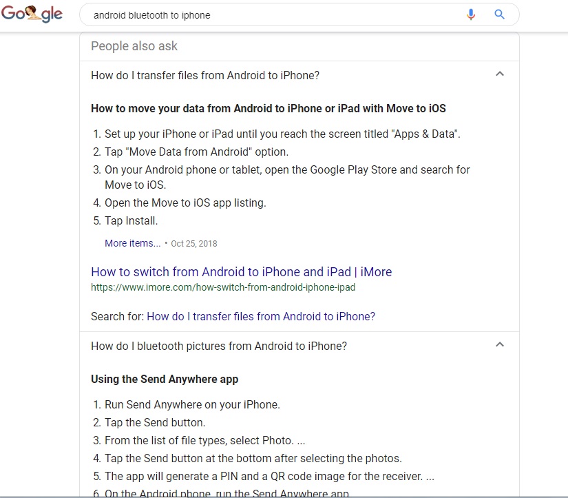

Thanks! I saw "Iphone". Ya know you can't even get an Apple phone to bluetooth to anything Android, while an Android unit will talk Bluetooth to anything that will listen to it. Does the TC work with Android stuff? -

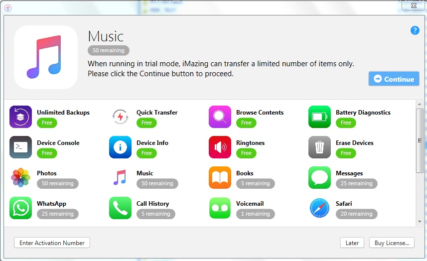

Well... it was fun while it lasted.. Version 2.9.11 of Imazing is now crippleware. Yeah, I know I could go back to Itunes since it is free, but that is why stuff like Imazing was invented is because Itunes is such a pain in the *&$. But now, at least Itunes is a free pain in the *#$. I'm junking all this apple stuff and going to a Cardo... What do you TC & Eluder guys use to transfer music/data? Does a TC or Eluder use a SD card? Or, Do you Android Bluetooth it or Apple Bluetooth it to the head unit from your phone/device? -

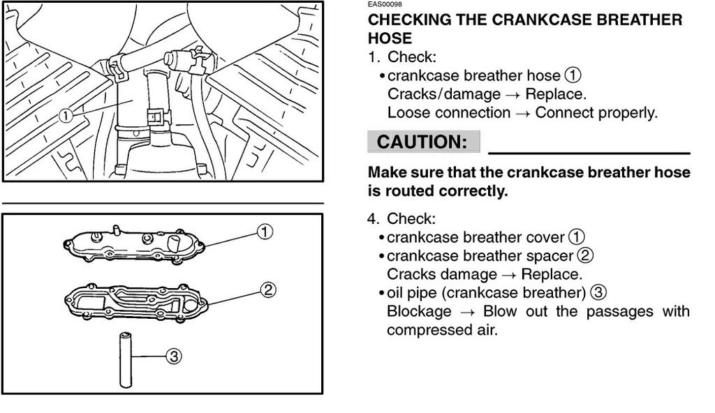

Which vent hose? Can you show us a picture?
Ok, RESIDUE is what you said. Not liquid oil right? "Residue" is ok. Liquid oil is not. If you have liquid in your airbox I am going with @videoarizona on this one as a blocked air vent. The oil is vaporizing and allowed to go up but when condensed, is slow to go back down. Check for a blockage. I live in Texas so I know a little something about heat. I run 10W-40 and on long trips at cruising speed I will even get a hint of oil mist out the breather tubes to the airfilters and I notice this because I clean the air filters every oil change, (blow off the big bugs at least) . I am talking about "residue", a couple drops, mist that has condensed back to liquid in the tubes and on the foam blockers in the leg guards, when I go slower than warp factor 1. Nothing to write home about. So... if you ride like a nut job in 100 degree heat at Warp 7 like I do, "residue" found inside the airbox every 5 or 10 thousand miles is perfectly ok. Here is how to check the breather. In fact, on some bikes, you have to dump out the LIQUID oil from the airbox reservoir every 4K miles or so and this is part of regular maintenance and applies to bikes that have the correct oil level.

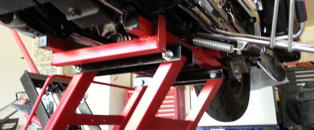

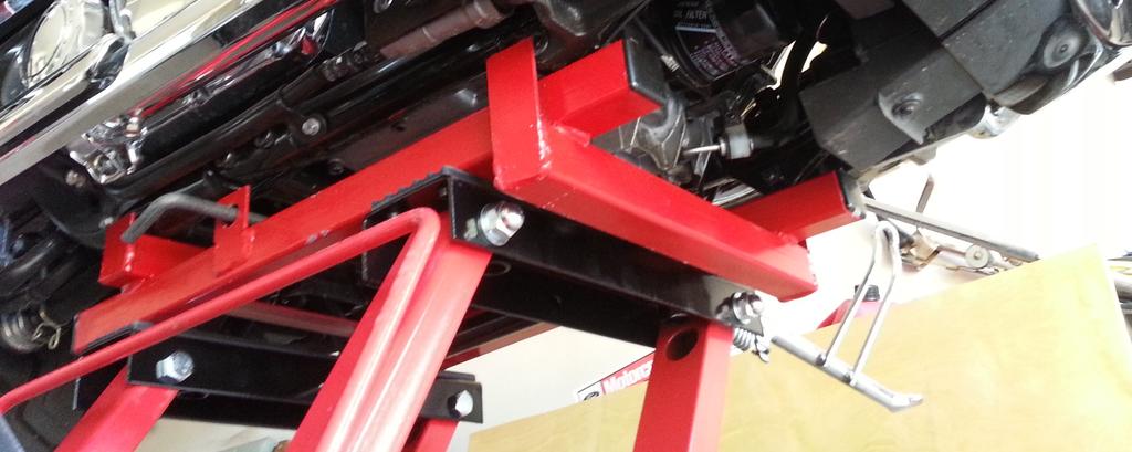

Ok, your bike is on a lift. Is your swingarm free to move up and down? That is what you need is a little up-down movement on the swingarm. SAFELY jack up the back end of the bike, while on the lift, another inch or so to give you the clearance you need. Do you have a drop out plate on your lift for the rear wheel? Same thing. Grease all the joints while you are there by the way. Page 7-66 of the service manual avail on here will help you out.
