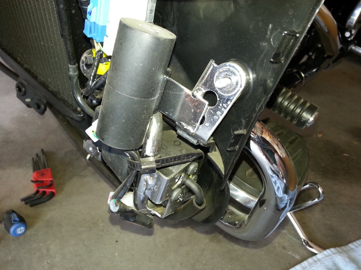

  2. @Dutch Navigatorit mounts on the bracket on the crashbar as shown in lower right of this pic.

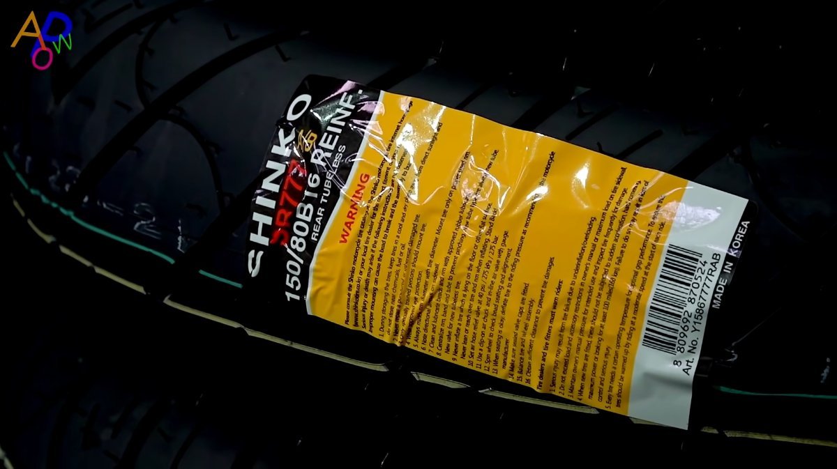

  4. Of course I use the 777. I like the way it rides, and it doesn't "sing-moan" in the corners like some other tires.

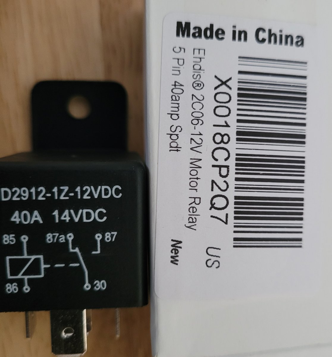

  7. Ignition Relay Ordered and Received. Bought TWO Ehdis 30amp/40amp 5-pin relays (two to a box) for $9.73 off ebay. Installed to replace original relay and now all is well. Posting this if it helps anybody in sourcing a replacement Ignition Key Add-On Relay (or just a 5-pin relay in general). VentureRelayInstalled.mp4

  9. Thanks @saddlebum for the tip, Yesterday I ordered the exact Songle relay from Amazon and it should be at my door Saturday.

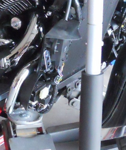

  13. 1265405964_7.FailedatOreillys.mp4

  15. @saddlebum , yeah... I gotta get the right relay. At the time I didnt have my glasses on and I was looking through the camera. Thought it had a diode...but no. This one is not sealed so I am going to go to the parts store (NAPA) and look for a sealed one. The ignition died on me 200 yards away from the house. She is a real beasty to push. Thanks!!! Yall have a nice Thanksgiving!
  16. @djh3 said, Standard Bosch type 30/40 amp relay. Available at auto parts store. https://www.oreillyauto.com/detail/c/standard-ignition/lighting---electrical/relays/accessory-relays/accessory-relay/09b63088360c/standard-ignition-5-terminal-multi-purpose-relay/std0/ry1770/v/a/97145/automotive-suv-2011-dodge-durango?pos=0 This one is pricey, but you get the idea rite? Yes sir, thank you. I just replied to your IM as well. I will obtain a relay locally.
