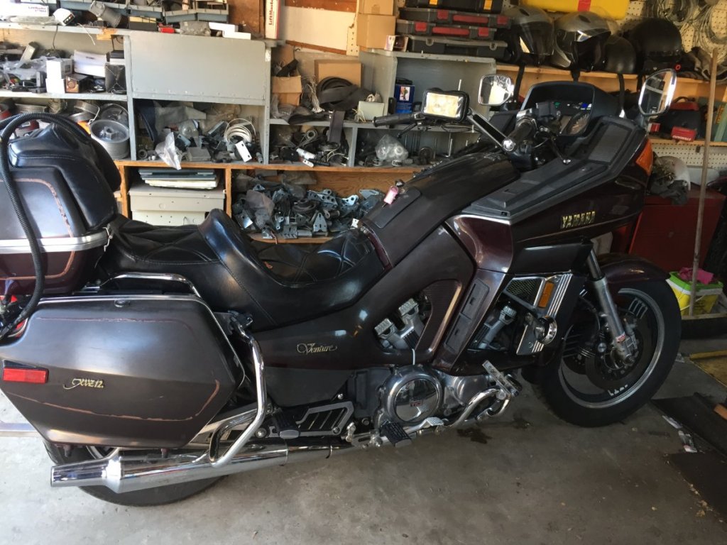

larrydr Posted March 1, 2021 Author Posted March 1, 2021 I brought back to life enough older bikes that did not run that one more would just be another bike . This my 83 Venture ..What I am finding is that just about the time when think you are done one to do repair shows up .
