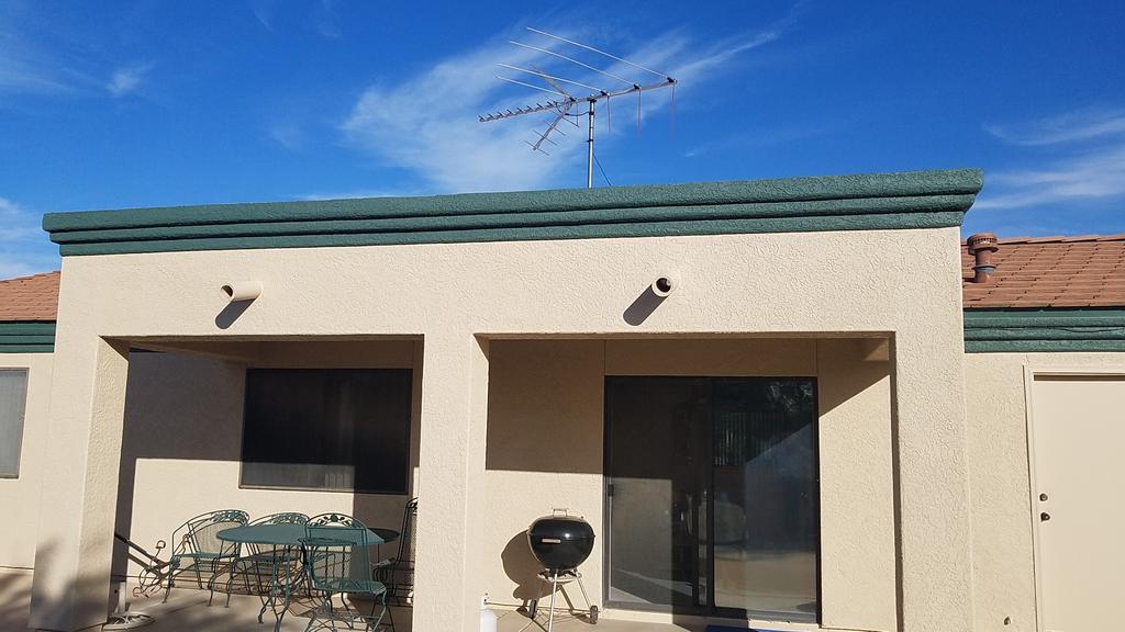

videoarizona Posted October 31, 2019 Share #25 Posted October 31, 2019 My old, beat up antenna. Link to comment Share on other sites More sharing options...
