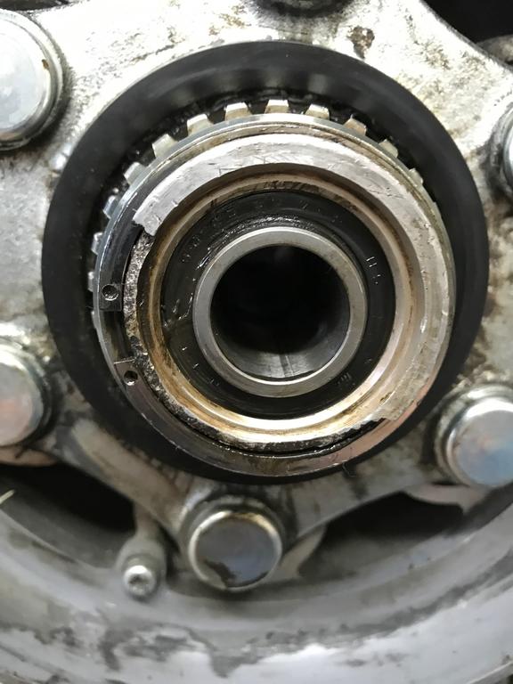

VanRiver Posted May 11, 2018 Share #15 Posted May 11, 2018 Hey @cowpuc ! Ever seen rear hub wear like this before? Here is a pic from my bike "Walt" when I changed the tire last year, the lip that holds the snap ring is chipped away. How the heck would that happen? Should I be concerned enough to replace the hub? Everything else was rock solid. Link to comment Share on other sites More sharing options...
cowpuc Posted May 11, 2018 Author Share #16 Posted May 11, 2018 Puc if you need a differential assembly I have one sitting here that was taken off for the trike conversion. Only has 10k miles on it so it's basically new so to speak. Larry Awe,,, YOU are the greatest Larry:bighug:!!!! I totally appreciate the offer my friend but in all actuality I am all set and got er good to go Larry - thinking that precious Tweeksis will outlast me now. So far this week: Swapped out the Progressive 420 that was under her for a good stock one, new Shinko's front and rear with beads, new brake pads front and rear/cleaned all caliper pistons, replaced worn hub, grease grease and more grease on pivots... Now all we need is some decent weather and its MD and then open the gate and get out the way,,,,, Tip, Tweeksis and Puc are headed to the west coast via,,,,,,, via what ever way the coin toss at the intersections lands Hey cowpuc ! Ever seen rear hub wear like this before? Here is a pic from my bike "Walt" when I changed the tire last year, the lip that holds the snap ring is chipped away. How the heck would that happen? Should I be concerned enough to replace the hub? Everything else was rock solid. http://www.venturerider.org/forum/attachment.php?attachmentid=112500 I am probably way wrong on this Riv but that dont look like hub damage,, that looks like wheel damage.. IMHO,, it almost looks like someone got aggressive trying to either take the snap ring off or they attempted to knock in back in place with a hammer and snapped the lip that catches the snap ring... At least,, thats what it looks like to me.. Not an extreme emergency IMHO but yea,, I would replace it,, I would find a good used wheel for it,, :backinmyday:one like I got xtra's of:big-grin-emoticon:... I would GLADLY swap ya a good one for a bad one (I would just give ya one but one of these parts bikes without a back wheel on it would be a REAL problem for your old buddy to move around)... ,, I just had an epiphany,,,,,, jump on Walt,,, head to Michigan,,, we can rip the old boy apart in my driveway out in the sunshine (FEELS GREAT being outside working again brother!!) and make the swap right here and it wont cost ya dime!!! I will also set up a Puc's MGnEM so the two of us dont starve = we can survive on 1/3 pound Hot Dogs cant we??!!!!! Link to comment Share on other sites More sharing options...
ShinySideUp Posted May 12, 2018 Share #17 Posted May 12, 2018 Hey cowpuc ! Ever seen rear hub wear like this before? Here is a pic from my bike "Walt" when I changed the tire last year, the lip that holds the snap ring is chipped away. How the heck would that happen? Should I be concerned enough to replace the hub? Everything else was rock solid. http://www.venturerider.org/forum/attachment.php?attachmentid=112500 That chips away much more and you won't have anything holding the snap ring! If it was mine, I would replace it. Link to comment Share on other sites More sharing options...

VanRiver Posted May 12, 2018 Share #20 Posted May 12, 2018 Thanks Puc for the insight, and I agree the damage must be from a previous owner who prefered using a 15lb Sledgehammer rather than a rubber mallet for "tapping things". For the life of me I cannot associate the chipping to friction or wear during regular operation. I really appreciate the offer of a swap/replacement, but I too am already "all set up". I have a spare sitting on a shelf in Arizona, just need to bring her home on our next trip. I would so love to swing by your place and take you up on the offer of some quality 1/3 pound hot dogs! Work has been really cramping my style and schedule. Was in London UK last week, Moline IL this week, and will be heading to the airport tomorrow to be in Montreal CA this next week. I'm totally jealous that my buddy @videoarizona is headed your way! I asked him to take lots of pictures and say "hi" to you and everyone else along the way......so I can live vicariously through his adventures! I am probably way wrong on this Riv but that dont look like hub damage,, that looks like wheel damage.. IMHO,, it almost looks like someone got aggressive trying to either take the snap ring off or they attempted to knock in back in place with a hammer and snapped the lip that catches the snap ring... At least,, thats what it looks like to me.. Not an extreme emergency IMHO but yea,, I would replace it,, I would find a good used wheel for it,, :backinmyday:one like I got xtra's of:big-grin-emoticon:... I would GLADLY swap ya a good one for a bad one (I would just give ya one but one of these parts bikes without a back wheel on it would be a REAL problem for your old buddy to move around)... ,, I just had an epiphany,,,,,, jump on Walt,,, head to Michigan,,, we can rip the old boy apart in my driveway out in the sunshine (FEELS GREAT being outside working again brother!!) and make the swap right here and it wont cost ya dime!!! I will also set up a Puc's MGnEM so the two of us dont starve = we can survive on 1/3 pound Hot Dogs cant we??!!!!! Link to comment Share on other sites More sharing options...
VanRiver Posted May 12, 2018 Share #21 Posted May 12, 2018 Hi @ShinySideUp (I like your forum name by the way!) I totally agree buddy! I can only imagine what would possibly happen if that Snap Ring worked it's way off the hub!!!! I will be replacing it ASAP once I get my hands on my Spare sitting in the hot garage down in Arizona. Not worth the risk. That chips away much more and you won't have anything holding the snap ring! If it was mine, I would replace it. Link to comment Share on other sites More sharing options...
