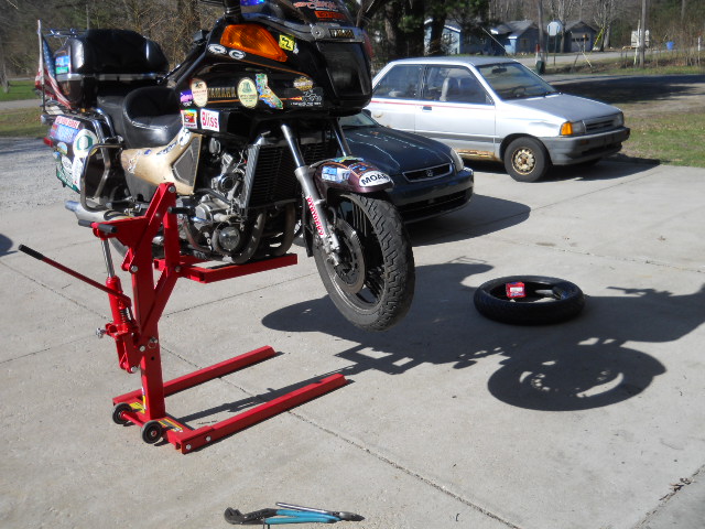

Find a tree branch low enough to toss a rope over, make a loop and attach a comealong, take two bike straps attach one to the rear grab hand on the side that is gonna be pointing up ward. Make a wrap around the handlebar that is gonna be pointing downward toward the bottom of the bar.. Attach the hoods of ratcheting end of the straps into the hook on the comealong, tighten the straps up with the ratchets. Lower the bike down with the comealong.. do your work and lift it back up with the comealong...
Use to do it all the time,, until I bought my lift from Harbor Freight
