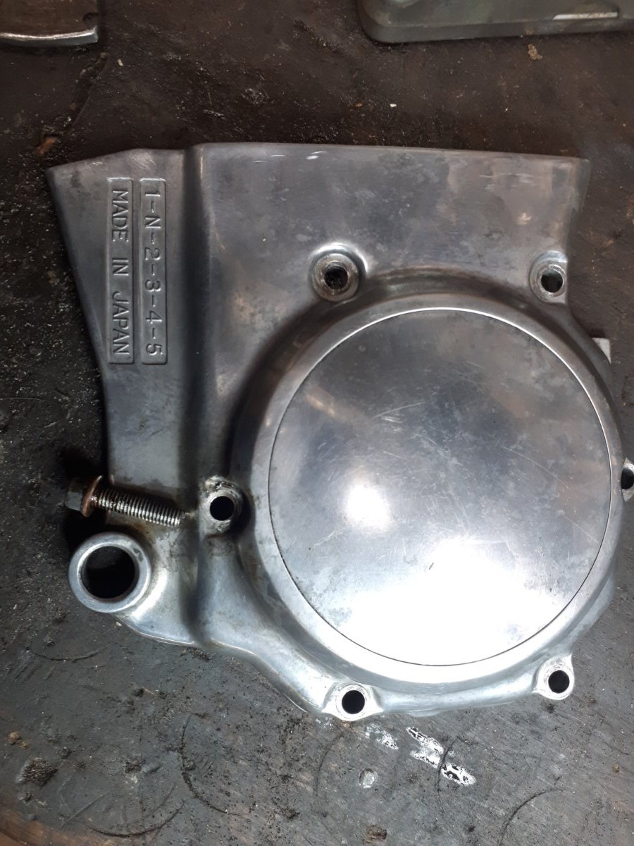

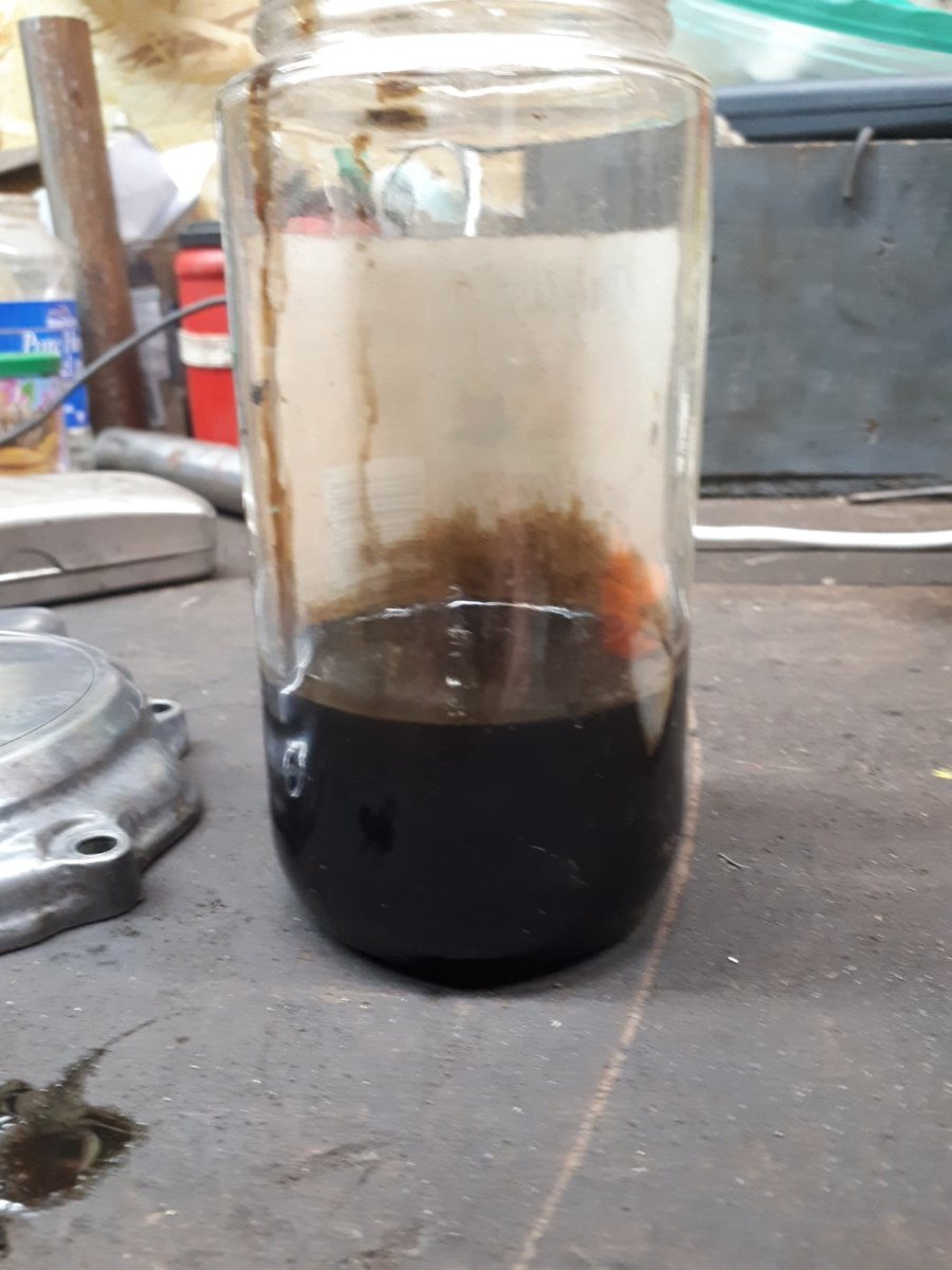

Something I forgot about until tonight while working on the bike. The transmission shaft cover on the left side is held on with a bunch of Allen head bolts. The bottom one has a copper washer and when you remove that bolt an extra 1/2 cup of oil drains out. If I being fussy with my oil change I will remove this bolt to drain the extra oil but most times I don't bother and that is why I probably didn't think to mention it earlier.
