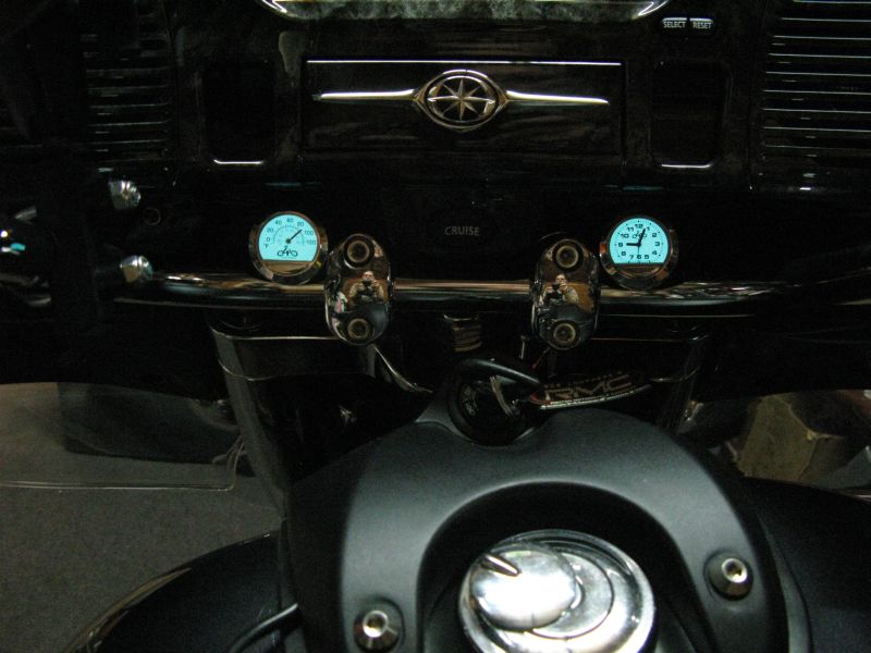

I posted the clock install here. http://www.venturerider.org/forum/showthread.php?51651-Clock-Install The temp gauge is not accurate being trapped behind the fairing. It reads about 10 degrees high. Mike -

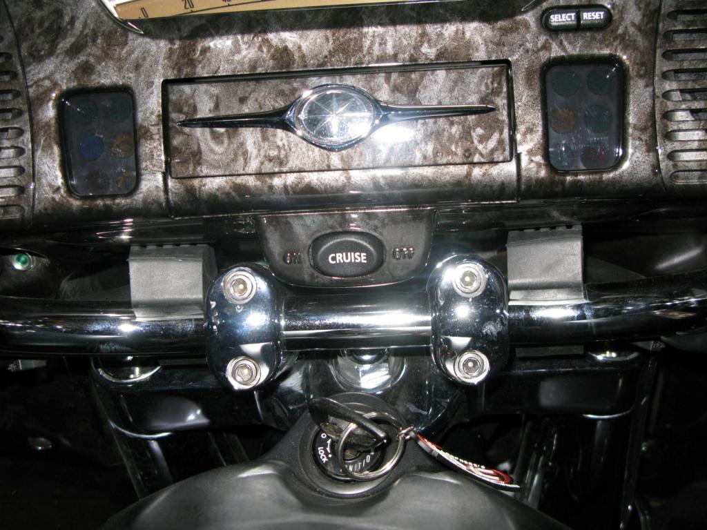

Don't know what to tell you. I have the riser extensions on my bike but I was able to squeeze the dampers in. It was tight but doable. See pic. Mike Click to view -
