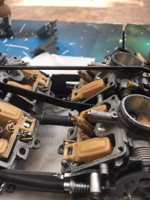

  10. If your removing your floats you will find those alignment supports in the way of removing the pin holding the float on two sides. A simple solution was to take a dremel and cut a notch into the support deep enough to clear the pin. Make sure you cover all carb openings including the fuel inlet before grinding. You can unscrew that idle adjustment screw for clearance. Don’t loose the spring.

  15. This will be my last post on this issue. Took my friends carbs and replaced the needle and seat assembly with KL parts. Thoroughly cleaned them. Float levels were good. Put it on and the bike fired right up. Took it for a test ride and she's running just fine now. Even the sync wasn't that far off. Im going to be out 500 bucks on this. Make no mistake about it. However. In any future dealings with any PayPal transactions, it will be as goods and services, not as a gift. At least that way it would give you some recourse. Ride safe and have a great Thanksgiving

  19. Another update: took the rebuilt carbs off for a third time now. Ran cleaner and compressed air through everything. The floats were way off too so I adjusted them to V7 Gooses settings, just like I did with my old 99. I found absolutely NO debris anywhere in the carbs or lines. Nothing in the needle or seat. Nothing in the flow chamber under the needle/seat. Even did the float test on each float and they were fine. Fired up the bike and within a few seconds, fuel was spilling back out the overflows once again. Only logical thing that I can come up with is its either a deeply crude passageway or a bad body. Now, ill say this again. I have extensive knowledge of the RSV. Learned through many years of working or customizing it. I even have 1st gen experience. Bottom line is that I gave this "plug and play" rebuilt carb set from Eykamp every opportunity to work. It is obviously a bad set. Unfortunately Eykamp refused to acknowledge and correct it and now has ceased all communications with me. He does not stand behind his work. So while many will defend him, I cannot. Im now out 500 bucks with no recourse. A good friend gave me a set off a RSV that he will be parting out. I know the set runs but im ordering a new KL rebuild kit and will replace the seats and needles myself. 86 bucks for the part and its not rocket science. Take this warning for what its worth. A warning. And in the future, if its a business transaction on PayPal, send it as such. At least you will have some type of protection.
