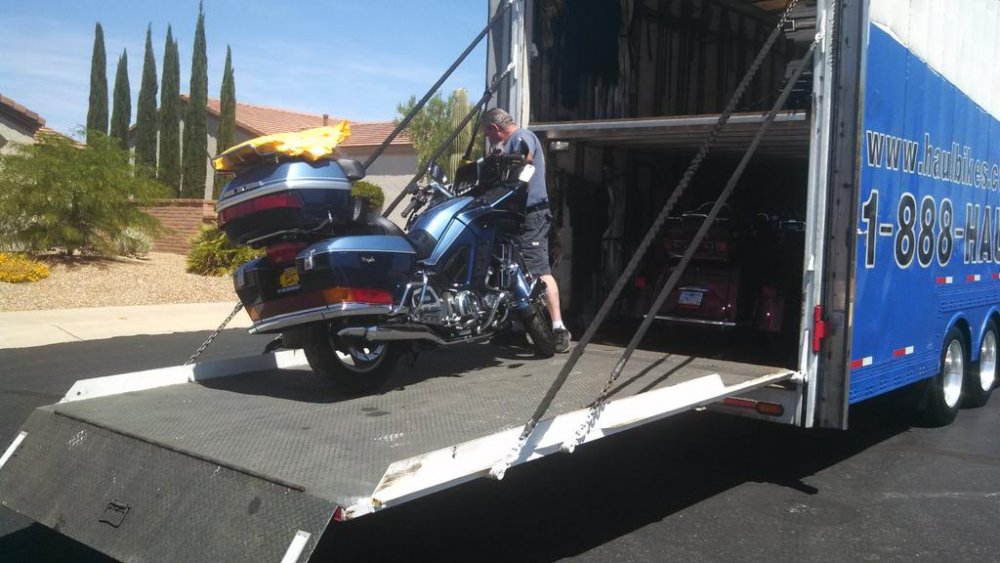

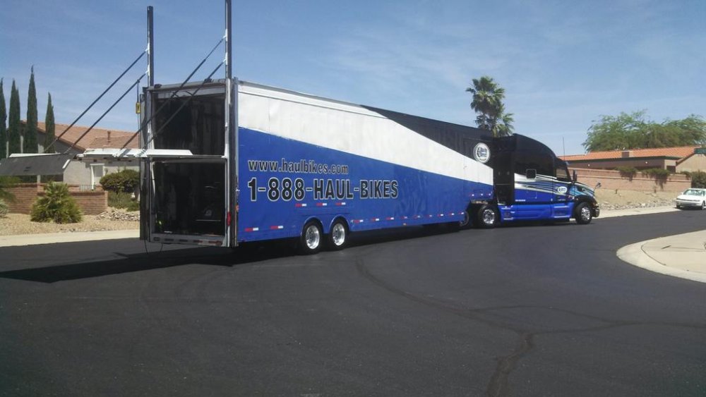

I used HaulBikes to bring the 89 1st Gen from Wisconsin to Tucson. They were excellent! The driver also rides. His HD trike can be seen in the top floor. It's white. Sorry, I had to change the post because I got my bottom and top floors mixed up. That's what I get for not going shopping yesterday...the family added about $20 worth of goodies for Easter dinner I didn't have. What you do need to know is they pick up your bike and take it to a central area to wait for the next run to wherever the scoot is going. In my case, I had to wait a few weeks as the West coast run had just left before I scheduled. But once on the road, the driver kept both the company and us customers in the loop, good communication. You may get lucky and get picked up in the middle of a run. I don't know how that works. I recommend them.
