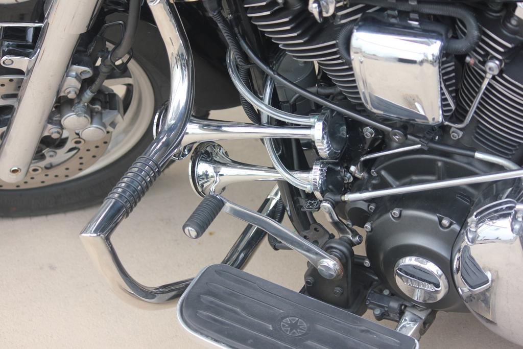

I had my first Stebel for about five years and removed it when the chrome finish was deteriorating. About three years ago I used the brackets that were made by SlowrollWV and mounted a Stebel on each side behind the passenger floorboards. Never had a problem with any of the three and I've ridden in some heavy rain, dust...
