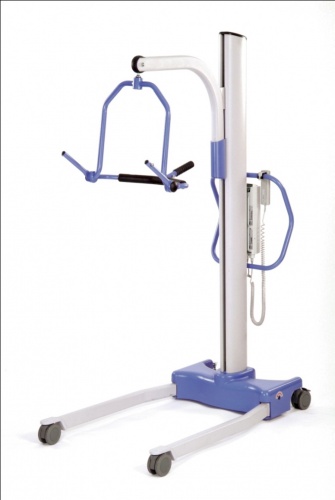

k9cottage Posted October 12, 2015 Share #24 Posted October 12, 2015 i use an old disability hoist from the local hospital cost 50$ works perfect for bike engines removal [an early version of this ] once you have the carbs off the lift arm fits neatly in the V . Link to comment Share on other sites More sharing options...
