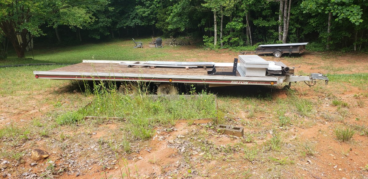

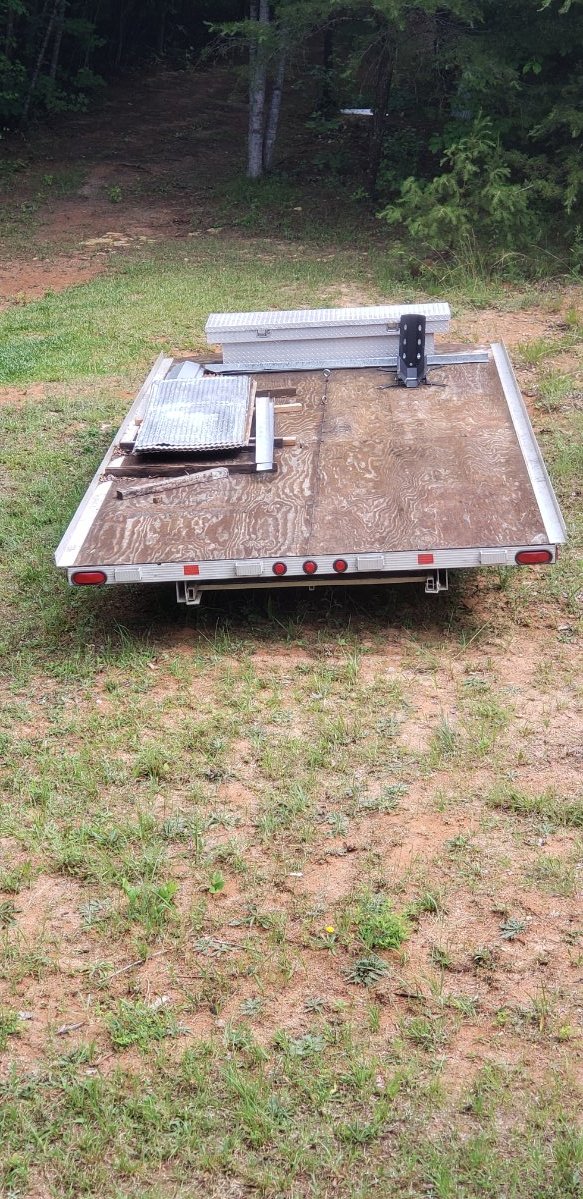

Here is my aluminum sled trailer that I have setup to haul both my 2 wheel RSV & my wifes Hannigan RSV at the same time. The trailer is 21 foot x 101 inches wide. Hauls both with room to spare.  The only downside to this trailer is the deck height, I have to raise the nose of the trailer to reduce the breakover angle of the ramp or risk high centering the bikes when loading or unloading. I do this in a number of ways.
1) use the tongue jack.
2) run the rear wheels of the tow vehicle up on ramps.
3)  back up to a raised section of ground to reduce the ramp angle.

19 hours ago, saddlebum said:
Have you thought about using arched ramps. Also I guess you needed the extra room on the trailer for the cases of Apple Pie
With the ramp I have, it stores below the deck, with an arched ramp it would need to be stored on top of the the deck.
Apple Pie... what do you think the storage box up front is for?  Sorry, no Canadian deliveries! Justin has the border sealed !

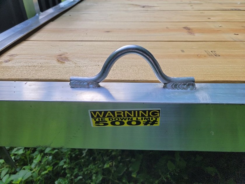

Haven't put the anchor points on yet.  Waiting on the bolts...decided to go with 5/16.
I don't know that I'd feel comfortable using the factory tie down points for a heavy bike.
I do know that I'll feel comfortable with the anchor points I'll install.
If that stated limit is per eye than you should be OK. provided they don't bend over under side pull tension. Some Aluminum alloys do not normally like to get bent as a rule.
